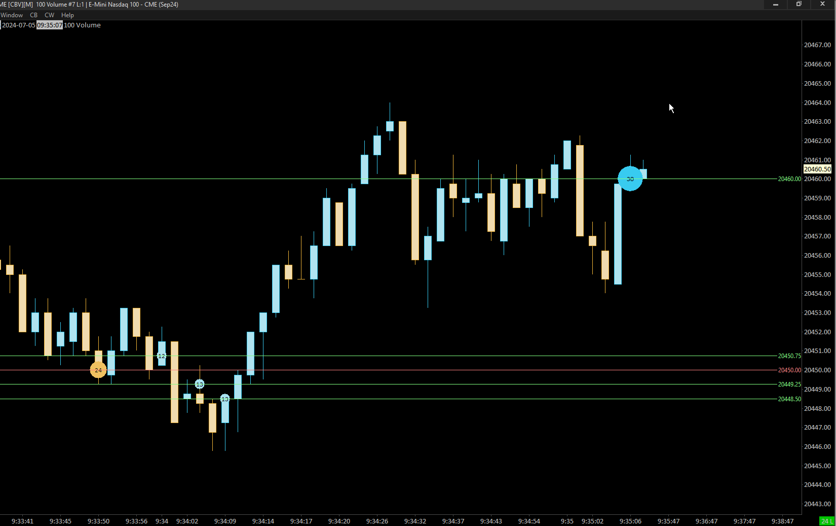

I would like to send a message because I can't solve my problem.
What I'm trying to do is to output the price level of large volume trades as we can see them on the time and sales window or on a chart with the Study "Large volume trade indicator" (Time and sales window and large trade on chart give the same results).
I tried to get the price with the Study "Time and sales price" but it doesn't fit at all. I am attaching 2 screenshots to show and explain the problem. I would like to point out that the trade combination parameters are identical for the graph and the time and sales window.
Does anyone have an idea to solve the problem or if there is a study already done to obtain this information ?
Thank you so much !
image2024-07-07 18_55_00 copie.png / V - Attached On 2024-07-07 17:59:06 UTC - Size: 168.63 KB - 268 views
image2024-07-07 19_22_06.png / V - Attached On 2024-07-07 17:59:13 UTC - Size: 44.85 KB - 247 views
[2024-07-07 18:29:27]
User431178 - Posts: 910
As you have already found, you cannot make the comparison between the T&S and LVTI.
This is because the time and sales study is not synchronized with the chart bars, so even though you compare data from same chart bar, they are unrelated.
Did you think to try adding the T&S Volume study and using that as a reference in the spreadsheet (instead of LVTI)? That way at least the price and volume you are comparing would actually be in sync with each other.
I am not a spreadsheet ninja, but I would've thought you would be able to persist the price values where the volume has met your specified threshold value and output those to the chart.
[2024-07-07 18:45:45]
User440951 - Posts: 54
Thanks for the feedback.
What i'm looking for is the price of the trades that appear on the time and sales window and only LVTI indicates exactly the same thing as this window. if it's to have other values ​​of large trades, i'm not interested.
I tried to put the periods of the bars in volumes, time or others, but nothing doesn’t do it, it doesn’t stick.
