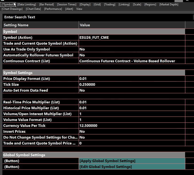

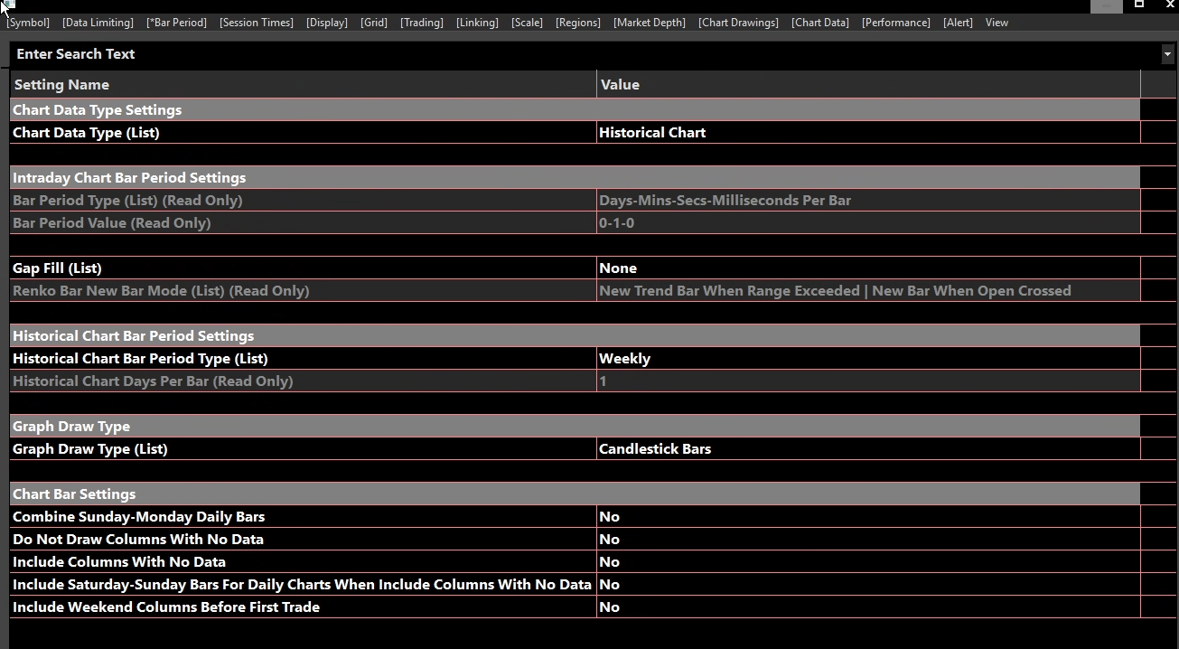

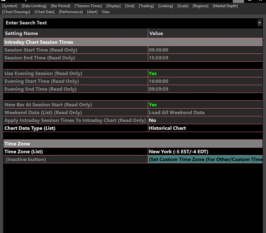

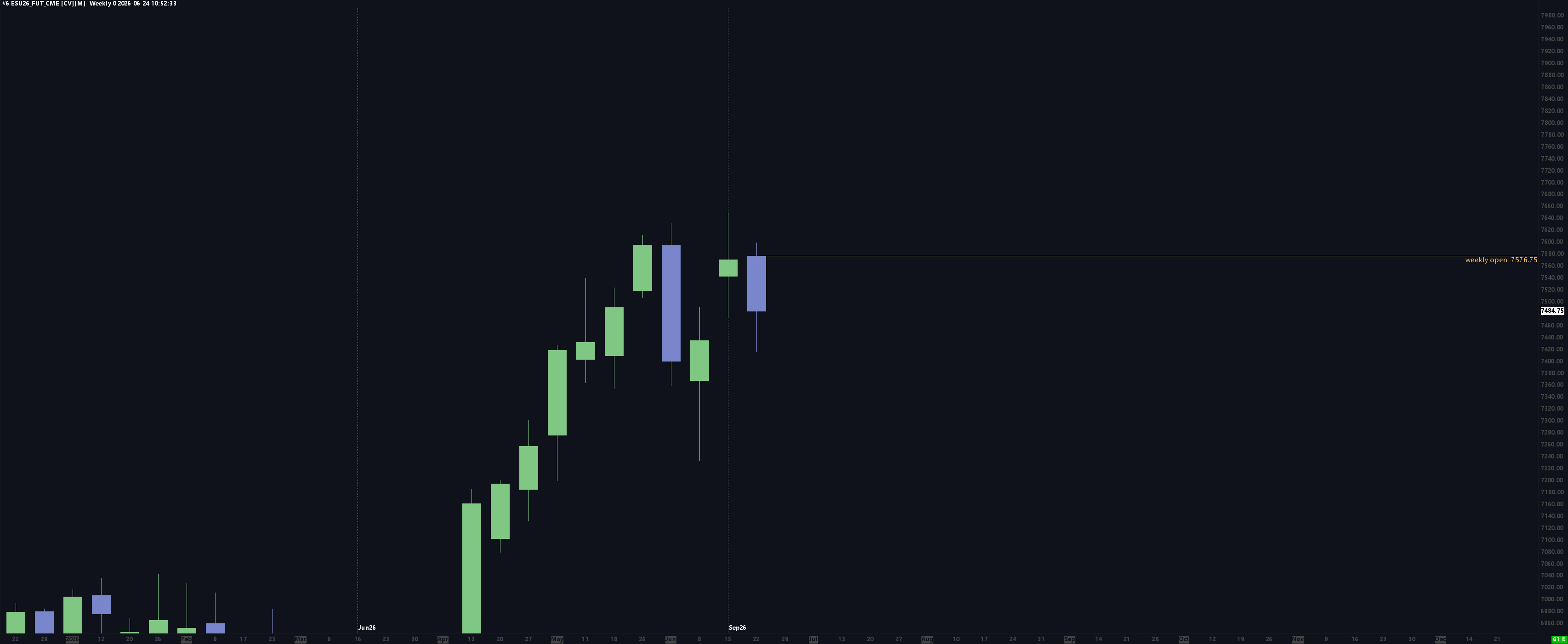

| mikrom - Posts: 12 |
https://www.sierrachart.com/image.php?Image=1782312755450.png The chart with the discrepancy is set up as a historical chart, see screenshots for exact settings. It's showing the weekly open of the current week at 7576.75. On the other platform the same weekly open is at 7543.25. However, the previous weekly candles show the exact same price on both platforms as far as I can see. Of course it could be the case that the other platform is incorrect or calculates something differently, in which case I will put more trust in my SC charts, but I want to make sure I didn't miss any setting that could have caused this discrepancy, so if you take a look I will appreciate it. Not sure if it has anything to do with last Friday being a half trading day on ES? |

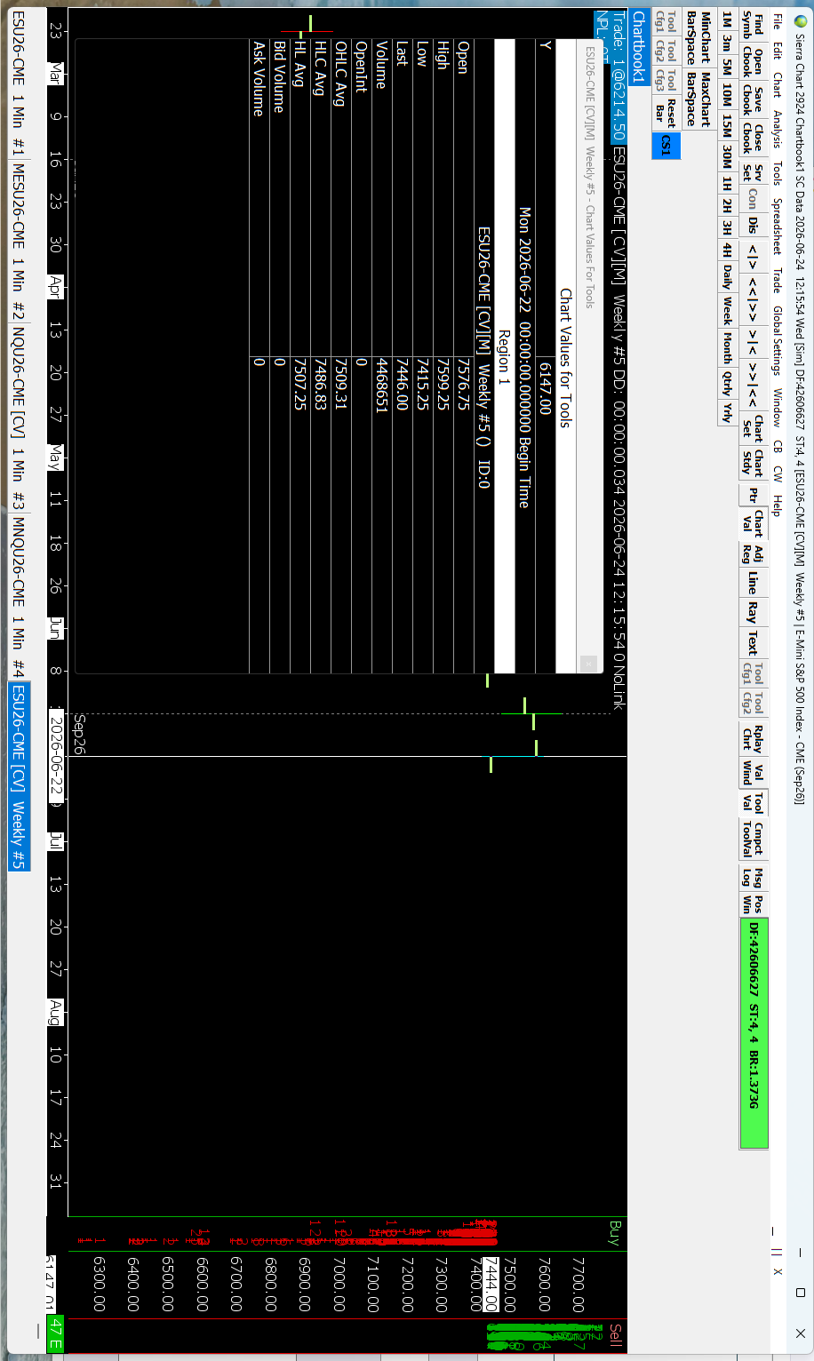

| John - SC Support - Posts: 48610 |
For a historical weekly chart, the Open of the week starting on Monday, June 22, 2026 is the following: 7576.75 Attached is an image showing this. This matches what you are seeing on your system. This is the reported Open of Monday June 22, 2026 from the CME Group for daily data. This is also the price of the first trade (Open) at 17:00:00 Thursday June 18, 2026 (Central US Time) - as the data from Thursday evening, Friday and Sunday evening are all part of the Monday trading due to the Juneteenth holiday on Friday June 19, 2026. Sierra Chart is definitely correct and usually is. For the most reliable, advanced, and zero cost futures order routing, use the Teton service: Sierra Chart Teton Futures Order Routing Date Time Of Last Edit: 2026-06-24 17:22:52
