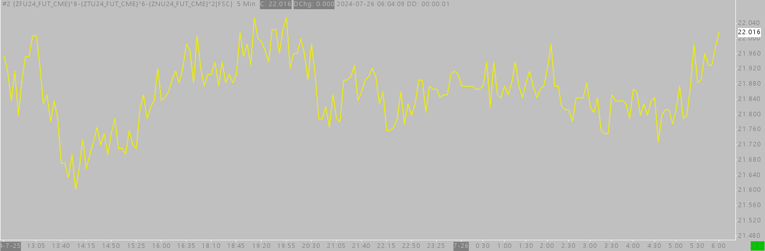

https://www.sierrachart.com/image.php?Image=1721988102835.png
| 2024-07-26 06:01:42.588
https://www.sierrachart.com/image.php?Image=1721988252938.png
| 2024-07-26 06:04:12.606
Below is the instrument I created- perhaps there is something I need to add on here that I am missing?

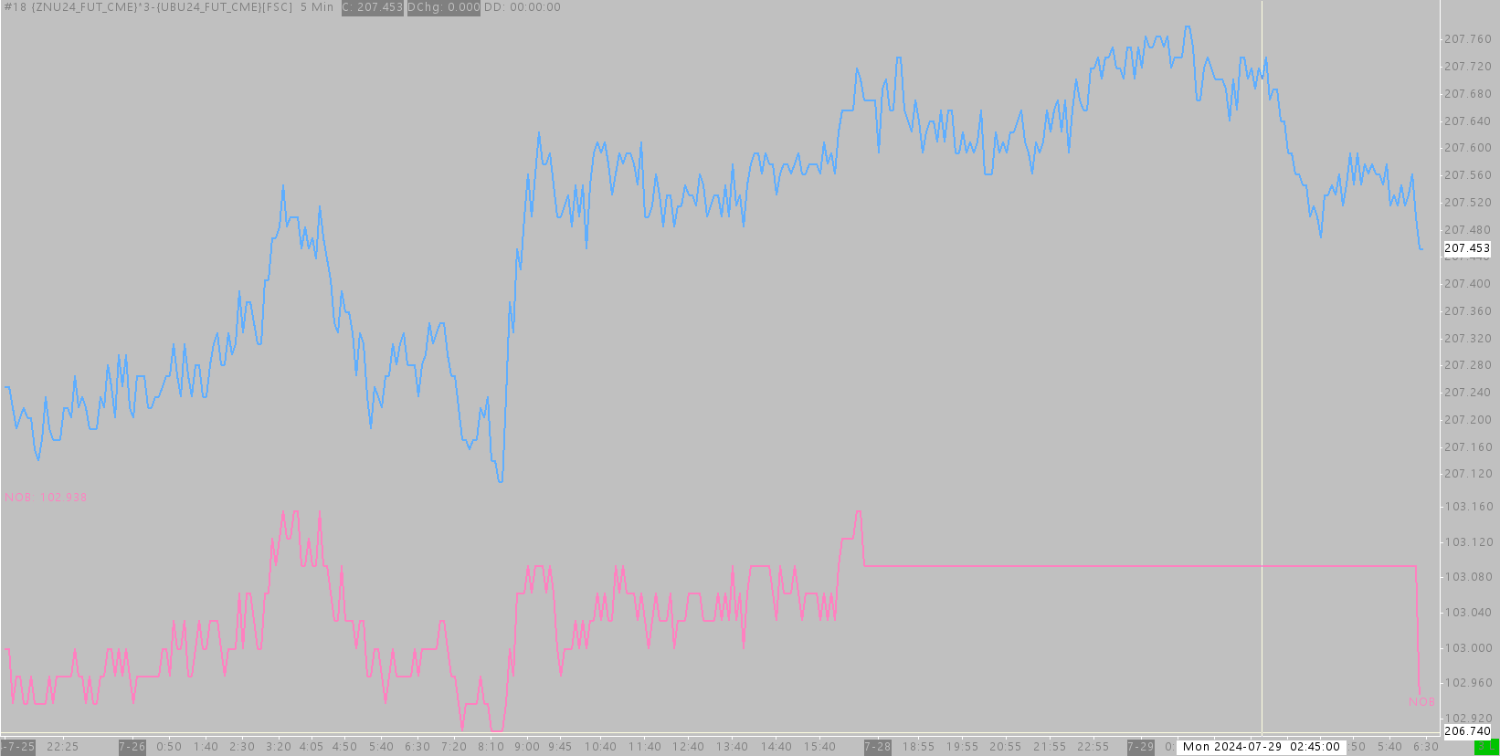

Please add the Custom Calculated Symbol into a different region - not in the same region as the main symbol for that chart and then get us an image of that chart. We want to be able to see the scales for that particular symbol.
[2024-07-29 10:28:55]
User198125 - Posts: 40
https://www.sierrachart.com/image.php?Image=1722248813121.png
| 2024-07-29 06:26:53.730
It's a different instrument as this one today is not working but the issue is the same.
Thank you
[2024-07-29 17:26:57]
Please open charts for the constituent symbols that make up that formula symbol (i.e ZNU24_FUT_CME and UBU24_FUT_CME) and make sure they both have data covering the time period where you see the flat line.

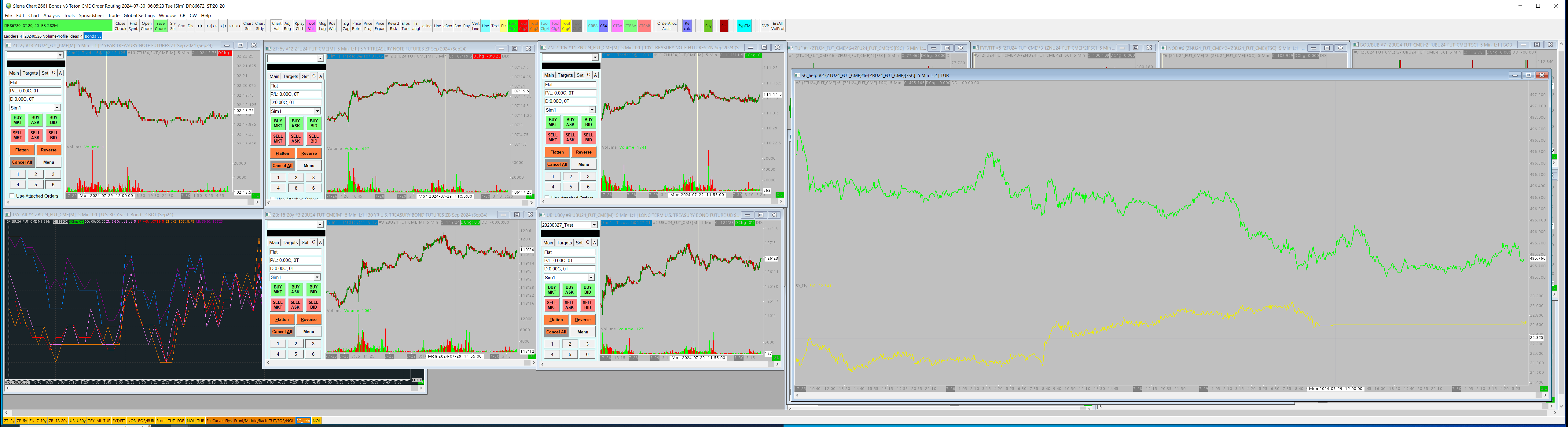

https://www.sierrachart.com/image.php?Image=1722333926694.png
All the data from the individual instruments are loaded and contain the data.
If you look at the image above, the charts on the left are all the individual instruments.
If you look at the yellow line on the right, this created using individual instruments.
If I delete the study, "Add additional symbol, and then ad it back in, then the yellow line will print. But this is impractical to do on manay charts every day.
Thank you.
[2024-07-30 14:58:27]
In this last image, what is entered for the "Add Additional Symbol" symbol? Please give us the information exactly as it is entered in the study.
