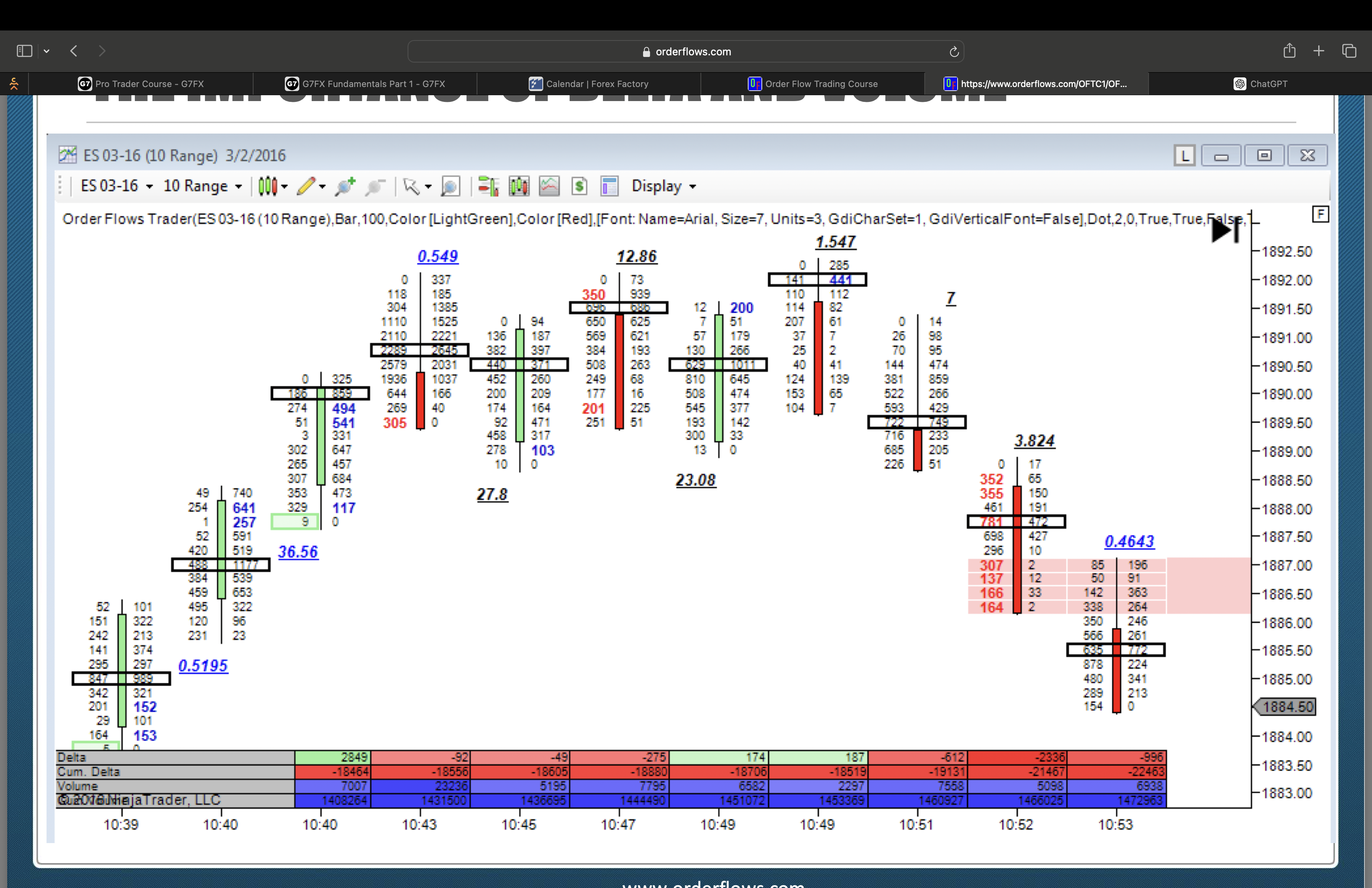

I need some help with a couple of adjustments in Sierra Chart:
Switching from Renko to Range Chart: I currently have my footprint charts set up with Renko bars, but I would like to change them to Range bars based on price changes rather than time intervals. Could you guide me through the process of making this change?
Displaying the Point of Control (POC) on the Range Chart: I am also trying to display the POC on my Renko charts, but it doesn’t seem to appear. Once I switch to Range bars, I would like to ensure that the POC is correctly displayed. Could you provide instructions on how to set this up?
imageScreenshot 2024-07-02 at 12.00.32 AM.png / V - Attached On 2024-07-02 17:19:29 UTC - Size: 4.67 MB - 571 views
[2024-07-02 17:21:11]
Refer to the following for how to change the Bar Period:
Changing Chart Bars Period
How are you displaying the Point of Control?
