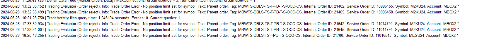

[2024-06-29 16:21:07]
Oxcap - Posts: 81
There were 3 errors listed in trade service log on Friday 6/28/24 you can use as example. I attached screenshot.
The symbols traded were M2K and MES on Account MBOX2.
Thank you
imageTrading Eval - Position Limit Error.png / V - Attached On 2024-06-29 16:20:26 UTC - Size: 34.9 KB - 244 views
[2024-06-29 18:45:35]
There are no limits set for any symbol. Documentation for how this is configured is here:
Trade Account and Risk Management: Symbol/Product Limits
We set a limit for you for "All_Symbols" of 10. So this globally applies to all symbols.

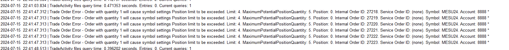

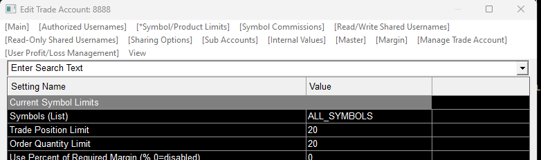

Hi - I have another question related to position limit. This is related to Account 8888.
I am testing on a separate strategy I have using this account. I set my symbol/product limits as 20. I also triple checked my position limits on the strategy itself that I have set.
I attached two (2) screenshots of the error message. I've been getting these messages only for MES while MNQ and MCL is fine.
Can you let me know what the issue might be? Is this Account 8888 issue or strategy settings issue?

[2024-07-16 21:57:54]
All_Symbols will not apply if there are specific symbols configured with Position limits. You need to check all of the symbols listed on the Symbol/Products Limits tab.

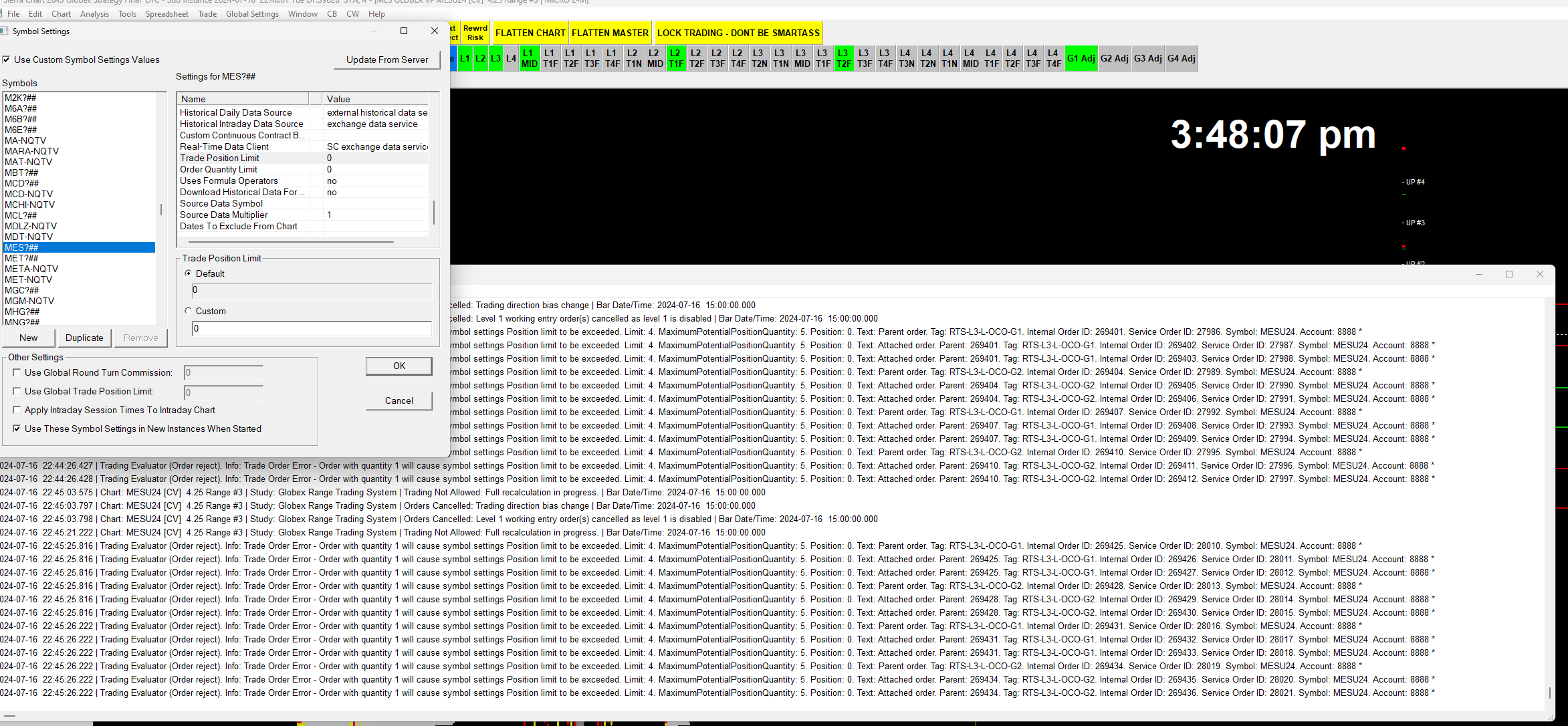

[2024-07-16 22:56:04]
Oxcap - Posts: 81
I went to global settings > symbol settings > MES to change the limit back to default 0.
MES,MCL, MNQ all have position/quantity limts set to 0.
This should allow All_Symbols to apply. I even increased from 20 to 50.
I am still seeing the message after changing. Am I doing this correct? See attachment.
Thank you
imageGlobex 3.png / V - Attached On 2024-07-16 22:51:53 UTC - Size: 293.05 KB - 148 views
[2024-07-17 02:36:54]
You need to check for other symbols within the list of symbols on the Symbol/Products Limits tab of the Trade Account settings window for the account. Where it says ALL_SYMBOLS, click there and then it becomes a list.
