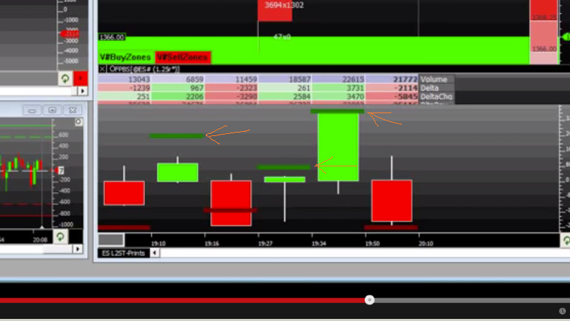

hi, i am a new user. i see studies that compare differences between charts but please point me to a way to plot the difference between the current Last value of the study and the previous bar's Last/Close value of the study.
the new difference study should overlay onto the underlying using the same scale. the plot of this bar-difference should be a simple horizontal line on top of the underlying study. Please see the orange arrows in the attached IR/T Cumulative Delta chart for reference.
thank you

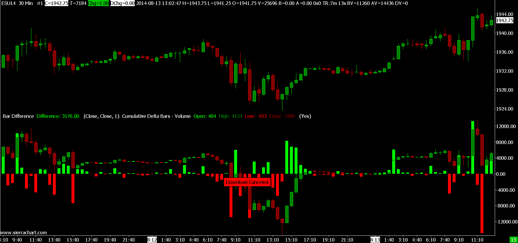

[2014-08-24 01:36:52]
1. This can be done by using the Bar Difference study and base it on another study:
Chart Studies: Settings and Inputs Tab >> Based On - Basing a Study on Another Study
In the Study Settings window for the study you will need to set the Scale for it to Independent and set it to the Chart Region you want it displayed in. There are numerous Subgraph Draw Styles you can use.

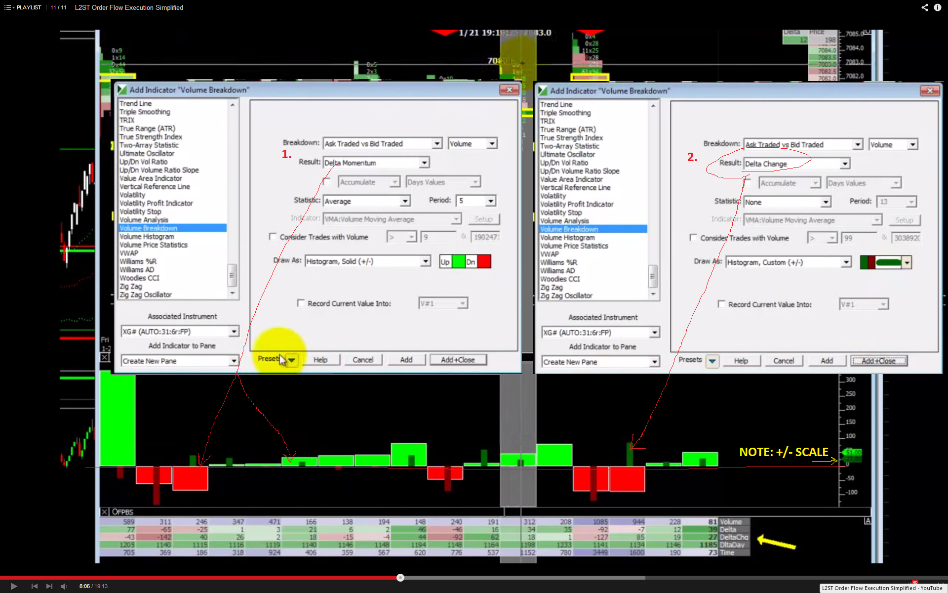

jivetrader - Posts: 410

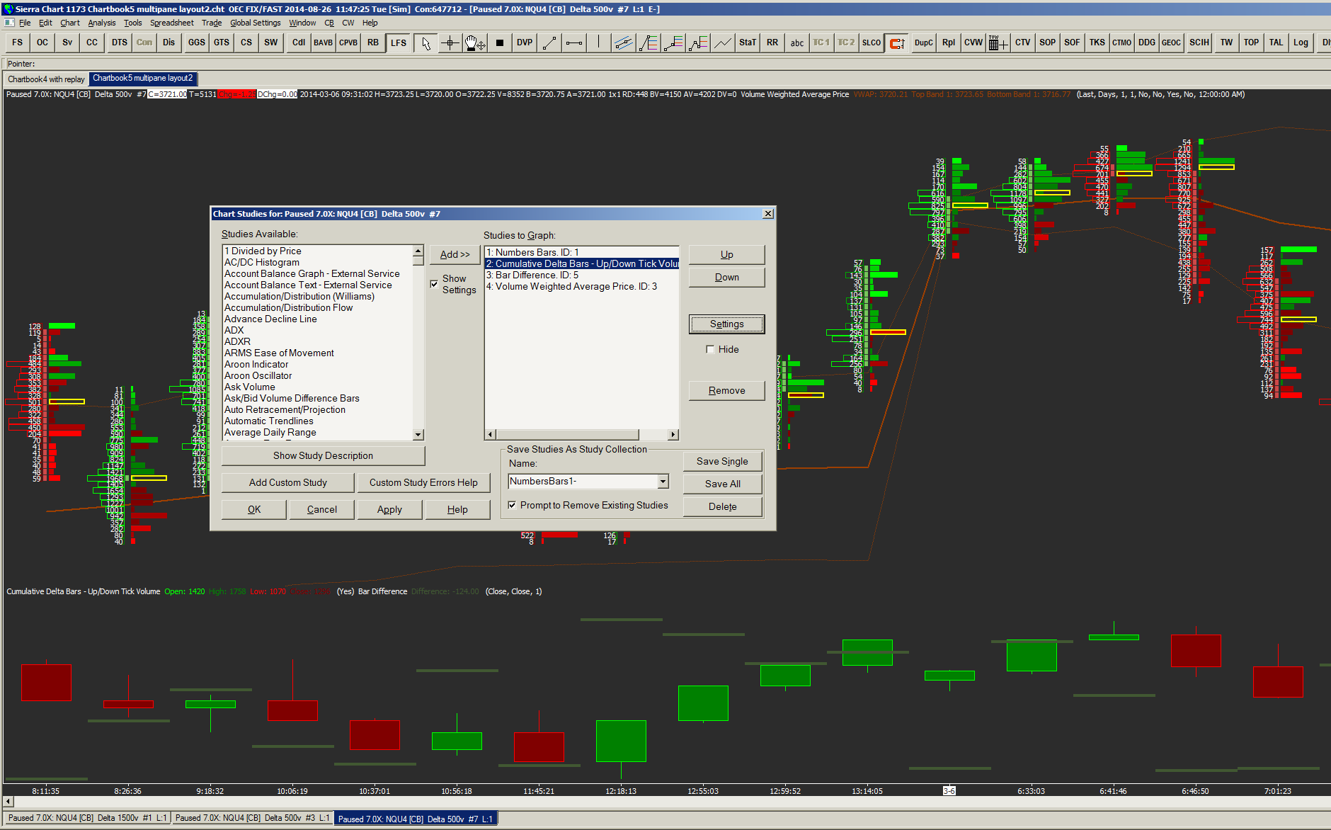

also, referring to question #1 above, how can i get CumDelta and Bar Difference (vs previous bar Close to current bar Last) lines as shown in the attached? for reference i am attaching comparable Investor RT settings for both versions of the indicator. i am trying to duplicate this setup, including its +/- 0 scale. thanks
imageask v bid delta change bars.png / V - Attached On 2014-08-25 05:24:06 UTC - Size: 1.26 MB - 732 views
[2014-08-26 09:26:49]
chart was using RLM-MU4, now i must use RJU14 for the SC Data Service.
You must use the symbols that correspond to the particular Data or Trading service you are using. You will find them in File >> Find Symbol.
but my question was, how do i get a longterm composite profile on an intraday chart? without it being slow to respond? i am using 2500 delta volume bars, not daily bars.
So you are referring to Volume Profiles? Not really sure there is an answer to this. If you are loading many years of data and you want a detailed Volume Profile on a chart of a short timeframe per bar, it could be slow.
You just need to overlay the two studies in the same region and make sure one of them has an Independent scale. This is documented here:
Chart Studies: Overlaying Studies in the Same Chart Region on a Chart
Here is an example:
http://www.sierrachart.com/image.php?l=1409045197643.png

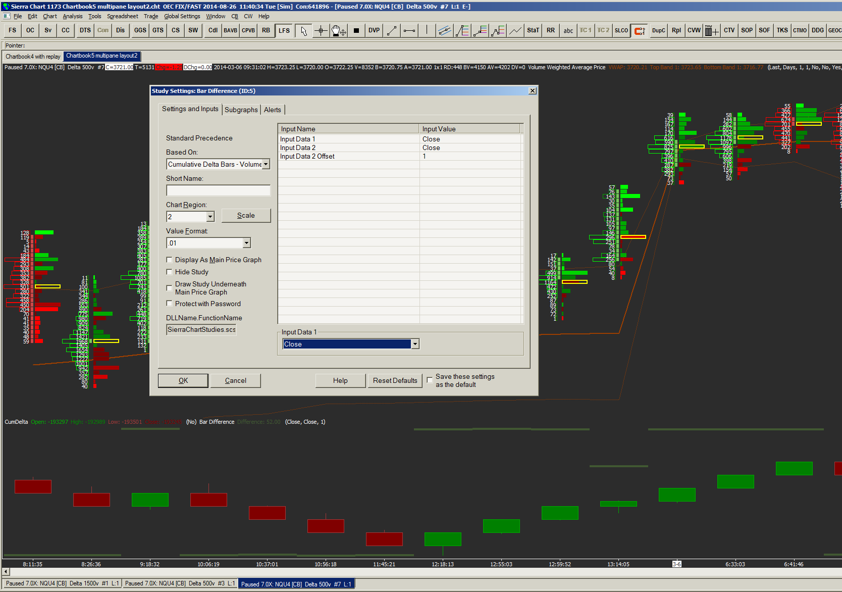

[2014-08-26 18:43:46]
ok, i have overlayed the two studies so that the dashed green line should represent the difference between the current and the previous bar, using Independent scale. but most of these dashes are pegged to the top or bottom of the chart. please advise on how to get a proper difference representation vs the previous bar that uses the whole scale proportionately. thanks.
imageask v bid delta change bars2.png / V - Attached On 2014-08-26 18:43:40 UTC - Size: 102.28 KB - 639 views

[2014-08-27 08:19:38]
Make sure the Bar Difference study has an Independent Scale Range and set the Draw Style for its Subgraph to Bar.
