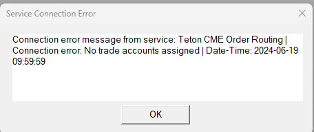

When I attempt to connect my Edgeclear/Ironbeam account to teton order routing I get the "no trade accounts assigned" service connection error. Can you please check if everything is ok on this end? I have activated CME top of book data but have not been charged yet, is this normal? I have been chatting with Edgeclear and they have so far been unable to resolve the issue so perhaps the issue is with ironbeam. Thank you for your help. I have enclosed the error pop up and the log.

imageScreenshot 2024-06-19 100348.png / V - Attached On 2024-06-19 16:07:23 UTC - Size: 7.06 KB - 264 views

Refer to the following:
Sierra Chart Teton Futures Order Routing: Common Mistakes
It is also possible that Ironbeam has not finished setting up the account, so you would need to check on this as well.
