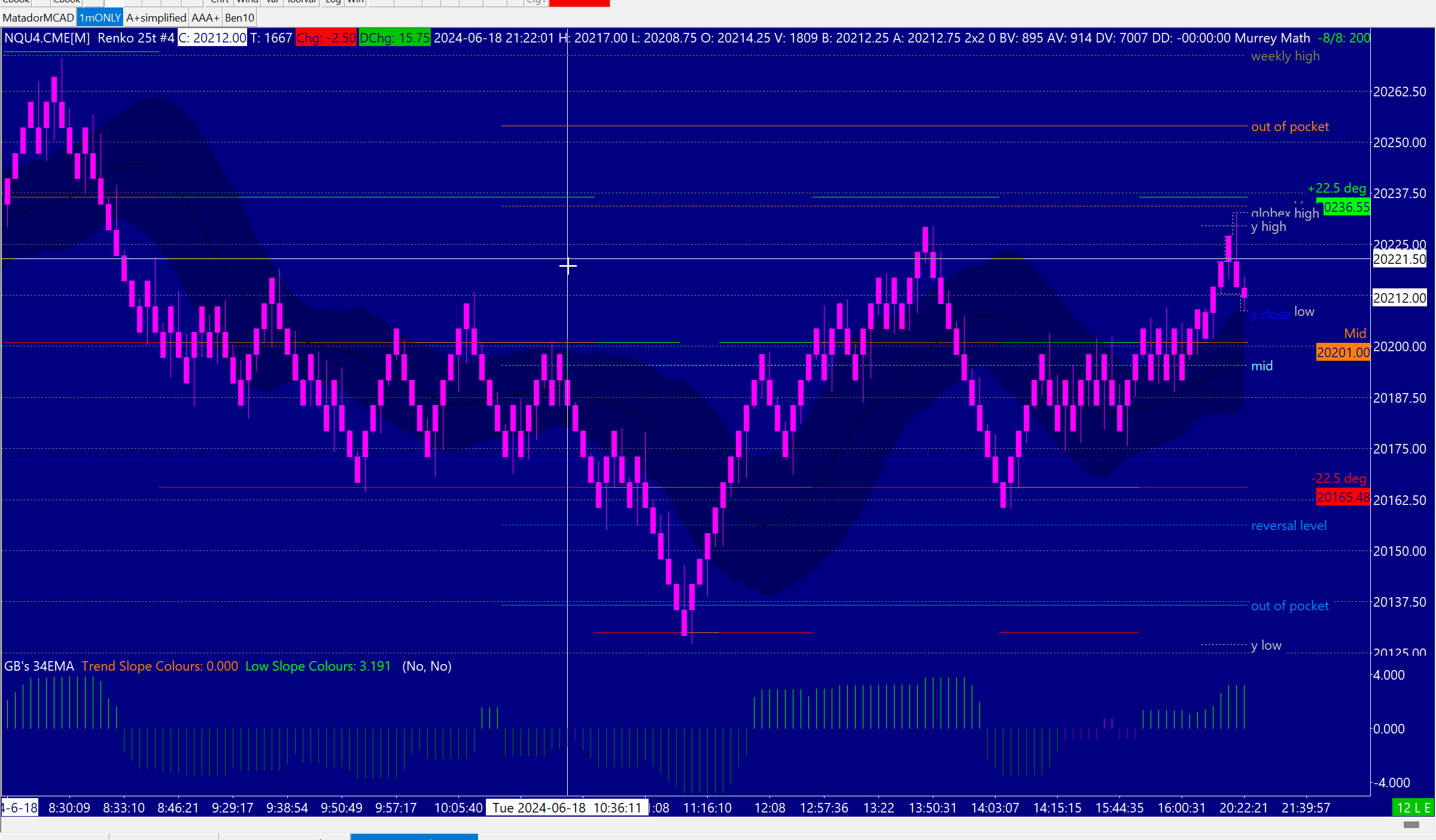

I am using GB's 34EMA (pictured below) and I have been trying every combination of formula's i can to get a color bar when the bars go above or below 1.
Can anybody offer some guidance?
Thanks!

From what we can see of this study, the bars are drawn using Subgraph 3 (SG3). So your formula would be the following:
=OR(ID1.SG3 > 1, ID1.SG3 < 1)
Where ID1 is the ID of the "GB's 34EMA" study.

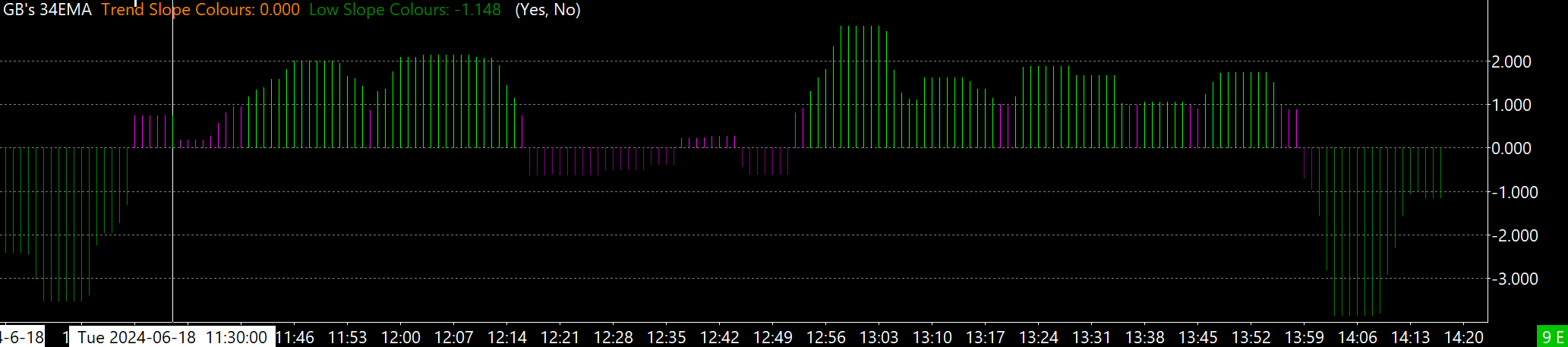

Hmmm.. that just colors every candle on the chart.

Sorry, we missed a negative sign. The formula should be the following:
=OR(ID1.SG3 > 1, ID1.SG3 < -1)

Thanks!
