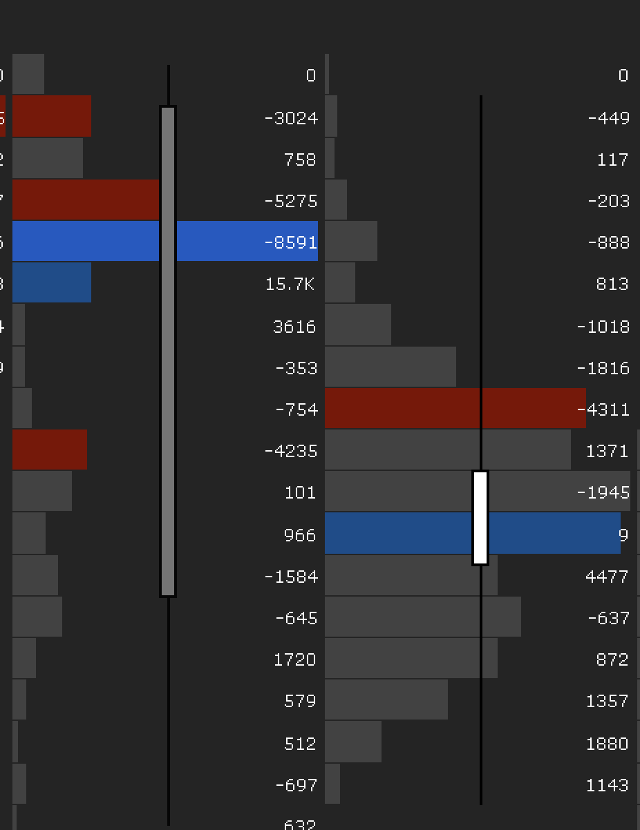

Hello, Sierra Chart Support Team! I have noticed a bug, I believe so, when using Numbers Bars. In particular, when setting the Column 1 Background Colouring Method to "Based on Diagonal Dominant AskVol-BidVol Difference". Attaching a screenshot of what ESM24 on 6-3-2024 looks like, 30minute chart, time: 9:00-10:00 (2 30min bars), tick size 0.25. I have the Compare threshold set to 2000,4000,7500, and notice when the row shows 15.7K on the left bar at the top, for some reason the row ABOVE gets coloured with bright blue, whereas the row above should be coloured in red and row with 15.7K with bright blue.
Same with the bar on the right, notice the only blue row is coloured where the Difference is 9, while the row BELOW is supposed to be in blue.
When the diagonal difference is negative, the colouring works fine, but not when positive.

How are you displaying the values for those numbers bars? What is the "Numbers Bars Text" set to?
[2024-06-18 15:39:39]
User840539 - Posts: 27
AskVol BidVol Diff Diagonal 1 Side
[2024-06-18 16:25:58]
There is no glitch. The issue is that you are only viewing the left side (Bid Volume at price minus Ask Volume at next higher price). You are not seeing the Ask side of things. You really need to see both sides of the Diagonal Difference in order to know which side is dominant. The background coloring is correct.

Understood, thank you for clarifying, John!
