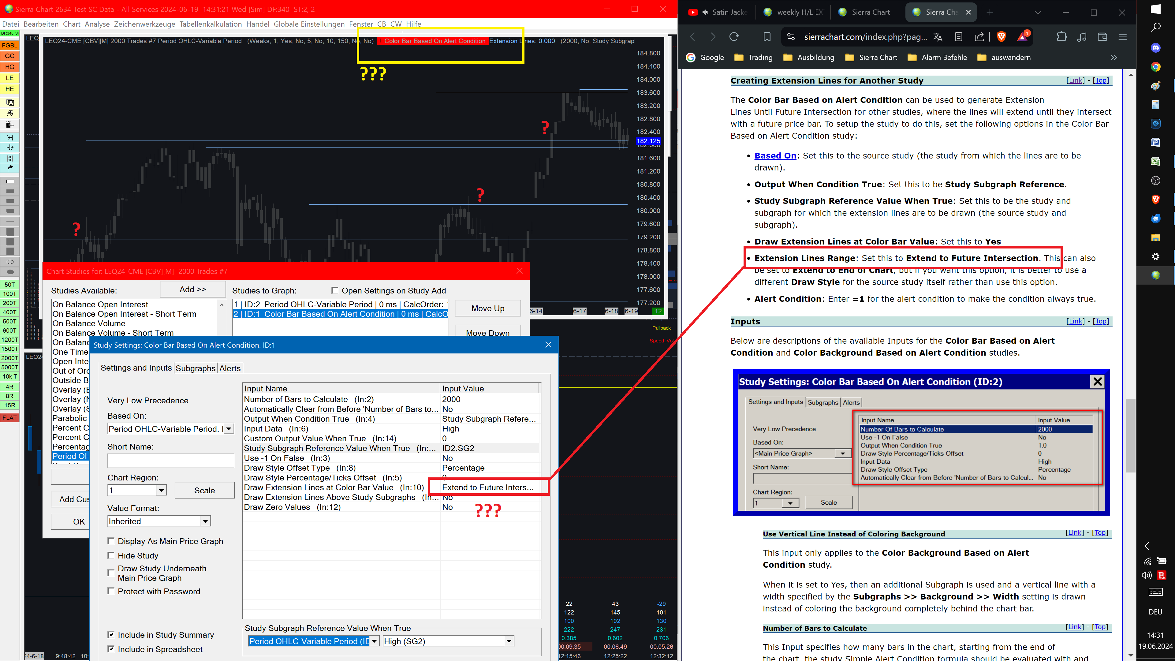

novaxt123 - Posts: 54
Hello
I made the settings as described in the Sierra Chart instructions (see the image on the right). I want to draw the weekly high and the line should end when the price crosses the line. But that doesn't work. What's wrong?
imagepicture.png / V - Attached On 2024-06-19 12:38:00 UTC - Size: 676.34 KB - 219 views
[2024-06-19 15:03:27]
Our apologies, the "Based On" documentation was not correct. We have updated it.
The "Based On" should be set to "<Main Price Graph>" in order to stop the extension lines at a future price bar.
