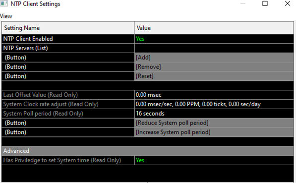

It looks like it's already enabled. I've attached a screenshot. Any other settings I need to make?

[2024-06-17 16:35:06]
User104854 - Posts: 460
Ever since I went to version 2644 it seems to be doing this. That's probably it.
I just went to version 2646 and it isn't happening. It's back down to 00:00:00. You guys did something to version 2644. I'm good now. Thank you.
