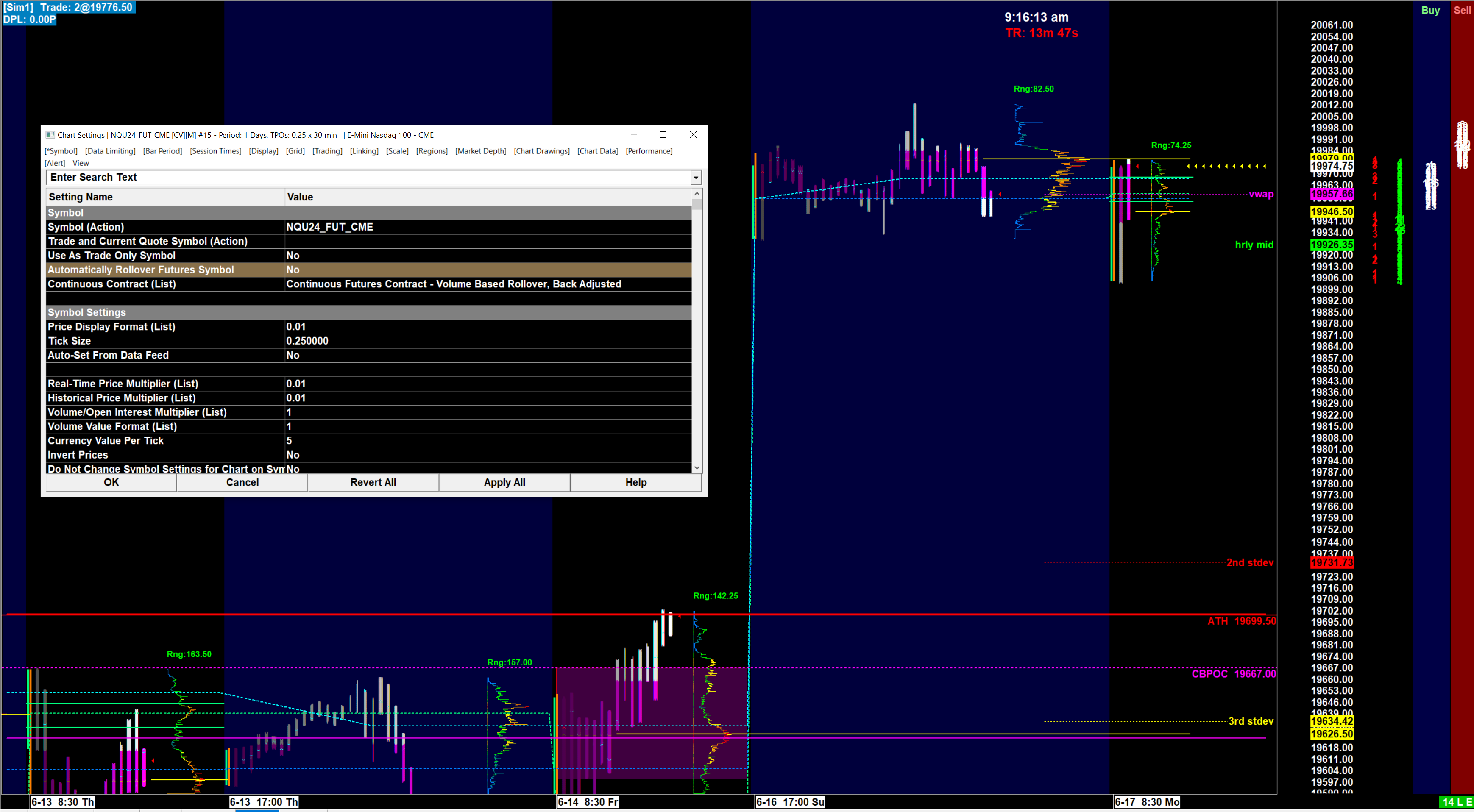

I rolled over from NQM24 to NQU24 but my historical charts are still showing NQM24 that's why I see a gap in charts. Please find attached the settings in the attached picture
imageRoll over issue.PNG / V - Attached On 2024-06-17 14:19:20 UTC - Size: 889.62 KB - 189 views

hamboz - Posts: 16
So I rolled over from NQM to NQU and I'm seeing NQM data till 6/16 and NQU data from 06/17 as shown in the attachment

John - SC Support - Posts: 48584
Please select "Edit >> Delete All Data and Download" and when you get the window to select the contracts to delete select the most recent 2 contracts (U and M). After the data downloads, the back adjustment should be correct.
