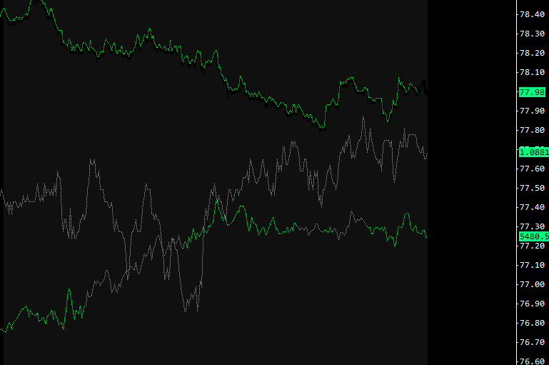

Hi there, looking to do something similar, did you manage to resolve your issue? i have a crude chart (being the main price graph) and 2 additional symbols (es and eurofx).
Just wanted something "simple" in my mind, that when commodities cross equites/ currencies etc and the permutations thereof, then enter 2 trades, opposing eg +1 crude -1 es if crude crosses es from below etc. With that being said im not sure if it can be done, as they use independent scaling.
I have a skeleton code of sorts, compiles but doesn't output result and im stuck! any help, tips, pointers much appreciated, welcome to the code for your own use.

imageScreenshot 2024-07-26 122641.png / V - Attached On 2024-07-26 11:27:22 UTC - Size: 23.31 KB - 294 views
