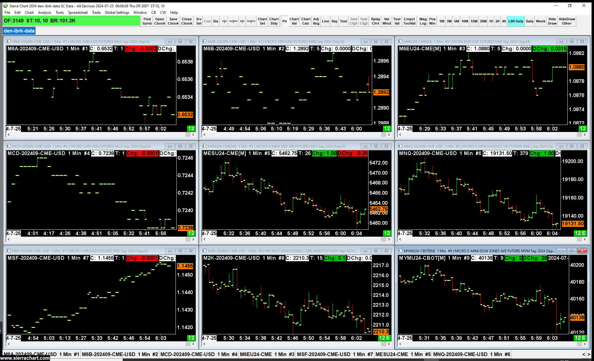

I've attached three screenshots:
SCDATA starting with correct symbols:
https://www.sierrachart.com/image.php?Image=1721901701673.png

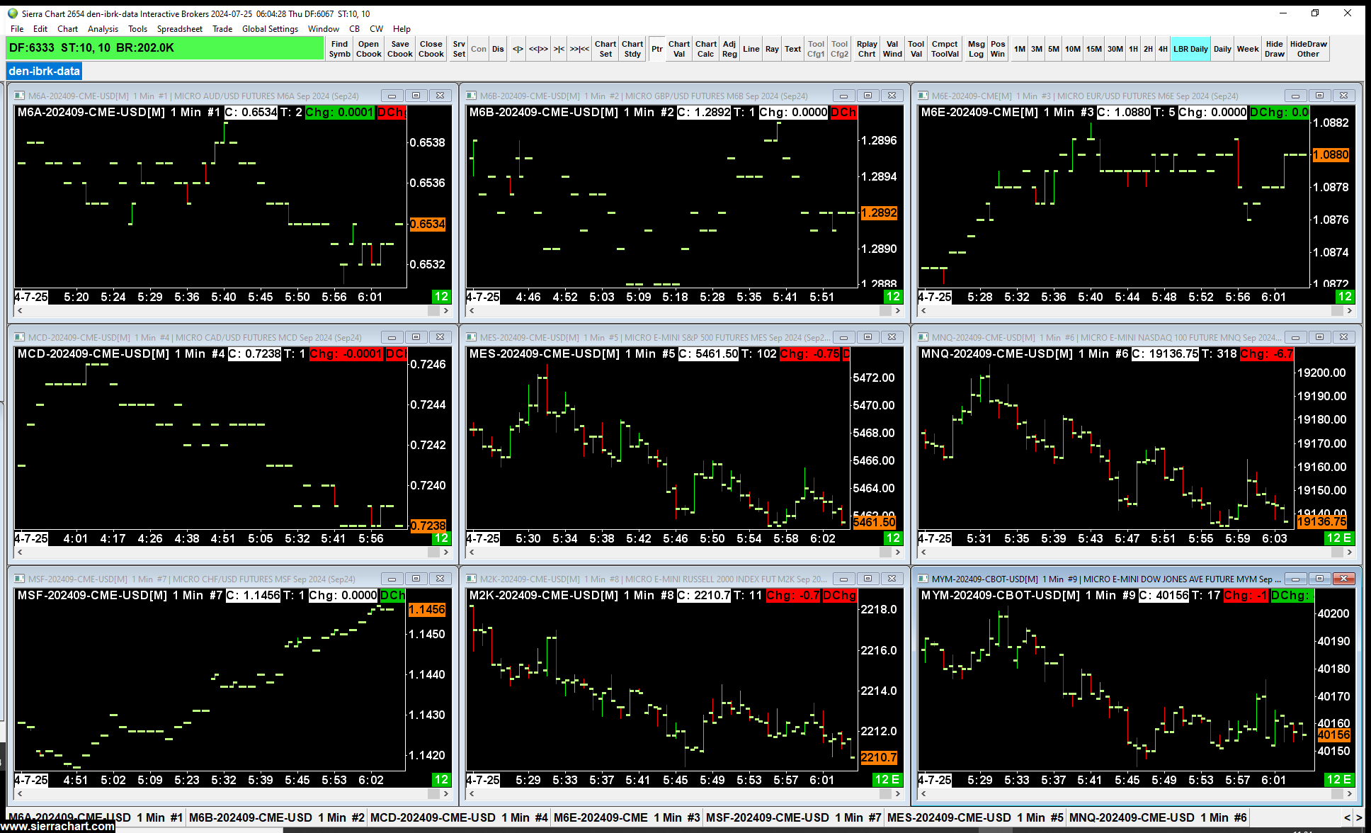

Move to IBRK DATA showing converted symbols:
https://www.sierrachart.com/image.php?Image=1721901871404.png

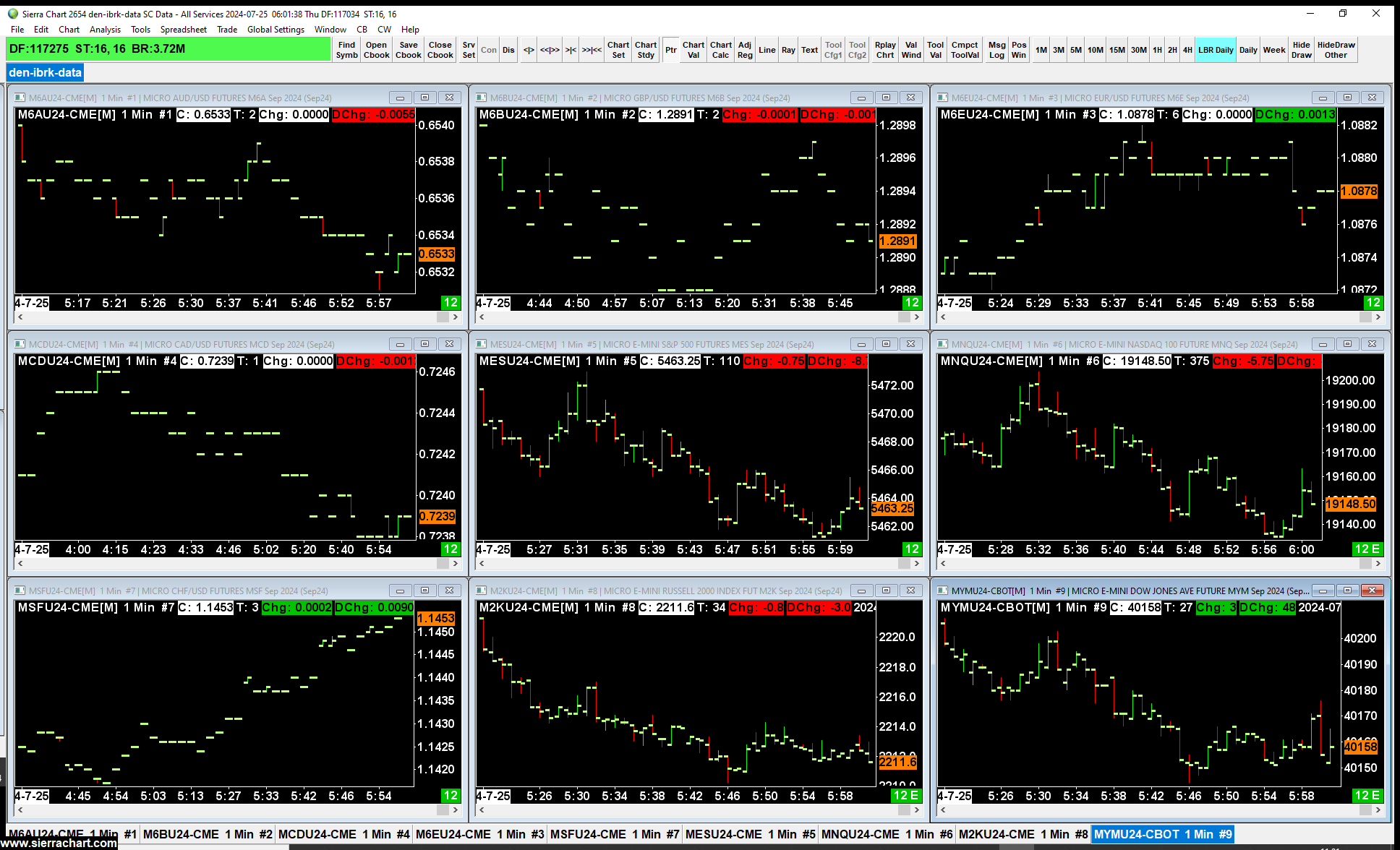

Move Back to SCDATA with only MESU24-CME, M6EU24-CME and MYMU24-CBOT converted back:
https://www.sierrachart.com/image.php?Image=1721901972270.png
