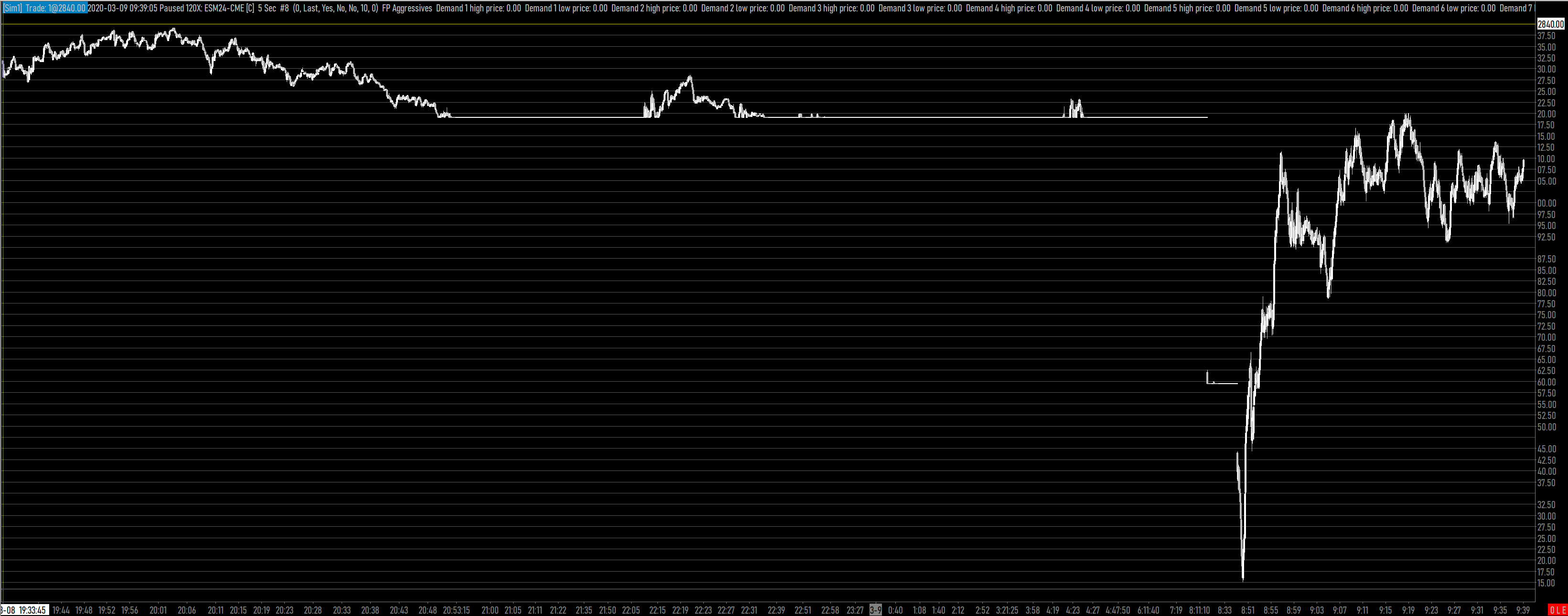

Can anyone else confirm this happens for you? Replay data from the close on March 8 2020, to the first 20 minutes of March 9, had some major gaps in it for me. I've verified this in two different actual copies of SC, as well as 2 additional sub-instances. See screenshot attached. This is of course resulted in some very bad trades going off in a bunch of long-term replays I've been gathering data on, and now that I've noticed them in the dataset, it's all invalidated. Would love to know if there is any way to fix this data.

No bad data, the "Circuit Breaker" was triggered at CME when the market was extremely volatile, that happened 5 times in the same month, (8-9, 11-12, 15-16, 23-24)
Check CME's documentation on "Circuit Breaker":
https://www.cmegroup.com/education/articles-and-reports/understanding-price-limits-and-circuit-breakers.html#circuit-breakers
I wouldn't practice those sessions, just because they are extremely rare and extremely RISKY situations, not sure if it will happen again before I die, even if it does, just take a day off.

Aha! I didn't think to check what was going on that day, thank you very much for the list! I will add them to the list of skip days. Much appreciated!
