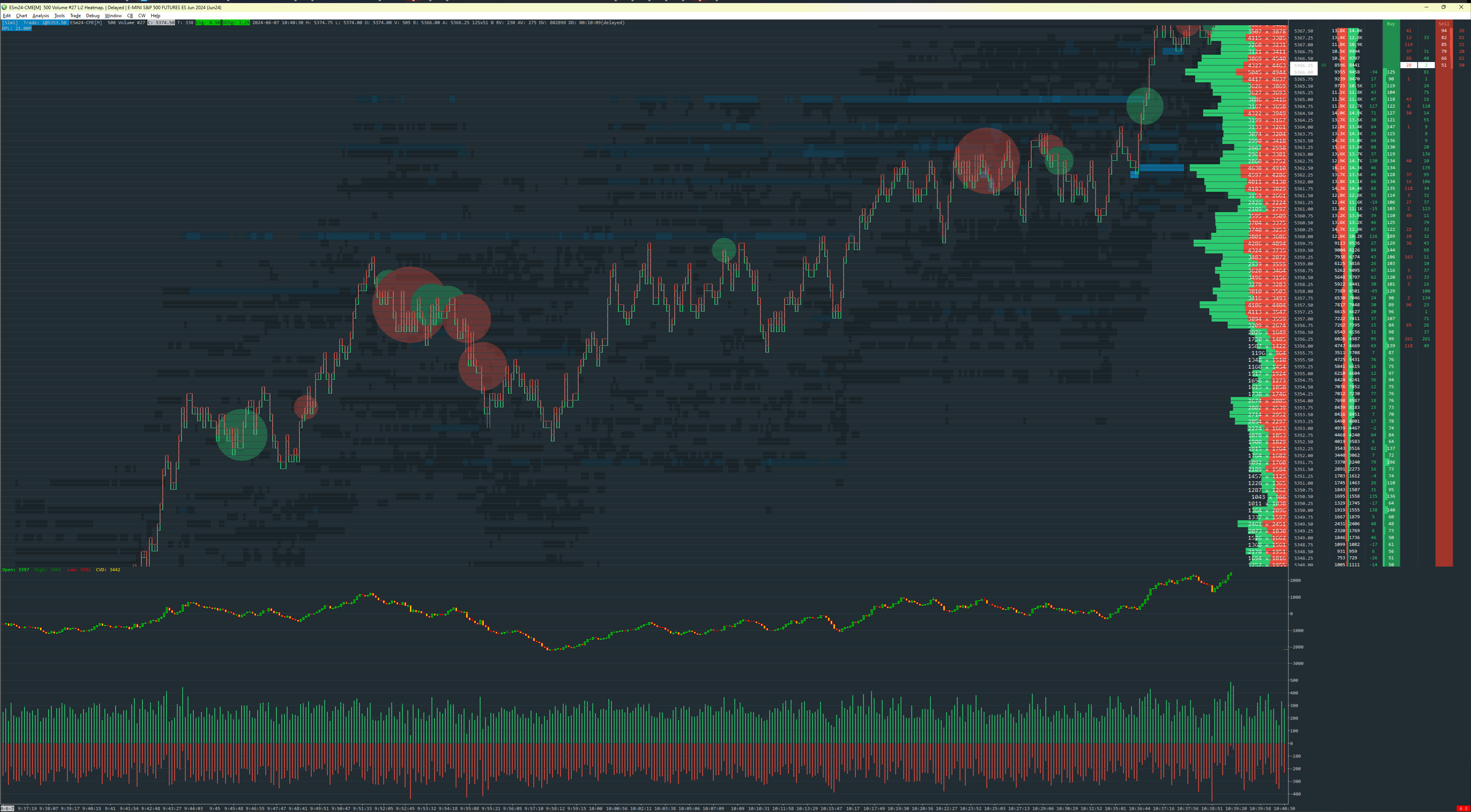

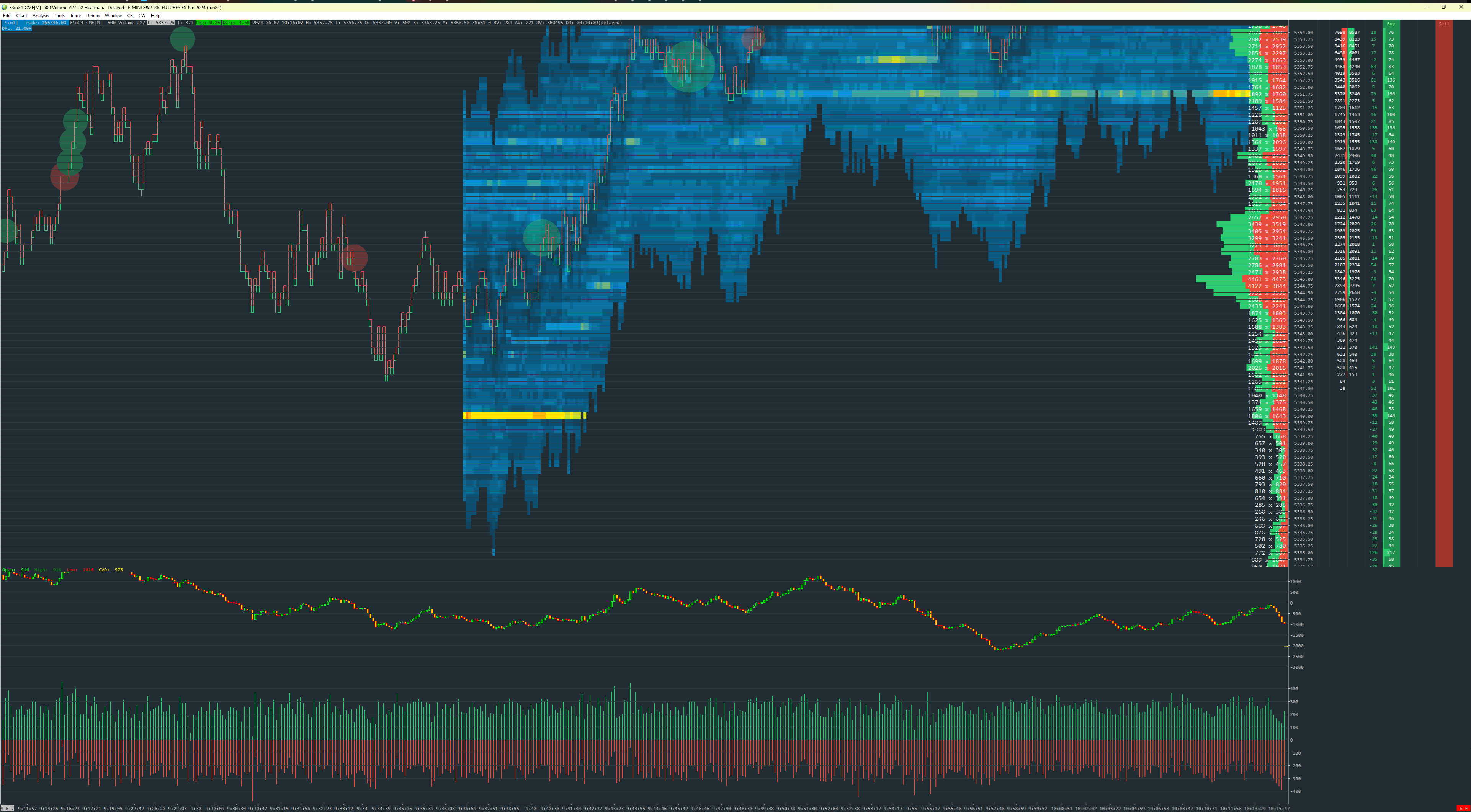

After searching Your Help-DB, extensive Google-/ChatGPT-ing, I wanted to ask, whether You are willing to add a "scale the DOM-Data logarithmically"-option for the market depth graph study .
As illustrated with the two screenshots, showing a small portion of a price-graph gives a good contrast, but showing a larger portion give a faint contrast.
So, I wanted to ask, whether I could be using some trick, like an intermediary study, or, whether Your could be adding the option (and deduct a fee of my account).
_Tschüß,
__Michael.
imageFeature-Suggestion.˸ study market depth chart logarithmic-L.png / V - Attached On 2024-06-07 16:44:28 UTC - Size: 615.1 KB - 399 views
imageFeature-Suggestion.˸ study market depth chart logarithmic-L.png / V - Attached On 2024-06-07 16:44:36 UTC - Size: 672.1 KB - 391 views

[2024-07-11 13:19:13]
User408639 - Posts: 83
Moin Moin.
(Excuse the dely, please.: I do remember to have been tping an answer, but semm to have forgotten, sending it. 8^0 ).
Well, this is a misunderstanding.: I did not mean to change the space-time-coordinate-grid of the Market Depth Historical Graph.
The idea is to change the colouring, as the LMT-depth is changing over more than one magnitude, this is going to hide most details, if there is a ver liquid spot.
This one is chning the experience of.:
1. the attached examples, or,

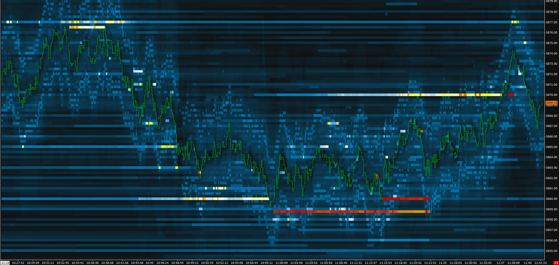

2.a. "https://www.sierrachart.com/Download.php?Folder=SupportBoard&download=73795" into
b. "https://bookmap.com/knowledgebase/assets/images/Heatmap_with_vertical_smoothing-063877e40c4ff0843af9138299a0587f.jpg".
If You can add a toggle to switch just the color-table from using the lookup-mechanisim to changing its hue and birghtness using the log of the LMT-number (, mapping the exceptional value 0 to 0.5), it would be a great help.
Right now, I have to move the map around to see, where I can find a patch showing only LMTs of th eame size, which is difficult.
