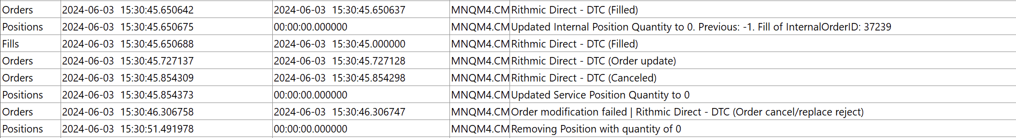

Understood - the error I am getting both in the Trade Activity Log and Trade Service log is:
"Order modification failed | Rithmic Direct - DTC (Order cancel/replace reject)"
See attached image below for the full sequence - thank you.
imageScreenshot 2024-06-06 at 11.34.44 PM.png / V - Attached On 2024-06-06 21:36:40 UTC - Size: 72.73 KB - 262 views

We cannot analyze a log from a screenshot. We need the information requested here:
Trade Activity Log Analysis: Support Assisted Trade Activity Log Analysis

Understood - attached is the Trade Activity Log data file from 06/03/24.
The symbol is MNQM4.CME
The account is APEX-75340-22
The order error in question happened several times during this session:
15:30:46 - internal order ID 37240
18:14:53 - internal order ID 37280
The timezone on the chartbook is CEST (UTC+2)
I use an automated trading system that executes market orders with an OCO bracket order from the trade configuration window; in my experience, when trading on the Rithmic data connection, in about 1-in-5 to 1-in-10 trades, when the TP limit order is hit/filled, the chart temporarily shows the position as closed and the OCO brackets disappear; but then a second or two later the stop-loss order re-appears on the screen (which I assume is a result of the order modification error). Sometimes I see this immediately, sometimes I only see it some time after the fact - there is no position on, but there is a still a working stop-order left over from the position. The only way I can get rid of this order is to hit flatten several times manually, and eventually, usually within 10-30 seconds, the remaining order flattens properly.
Please let me know if you need any more information from me - thank you very much.

We would recommend reconnecting in this case with File >> Reconnect.
What happened is there was an order modification at the same time Rithmic canceled the order and then when Rithmic indicated there is a rejection, it provided the status as Open:
Orders  2024-06-03 09:30:46.306758  2024-06-03 09:30:46.306747  MNQM4.CME  Order modification failed | Rithmic Direct - DTC (Order cancel/replace reject)  37240  1449078962  Stop  1  Buy  1872400.0000000    Open      APEX-75340-22  Close  37238          ScalpOF  0.00  1449078962  37240.29271  Good till Canceled
