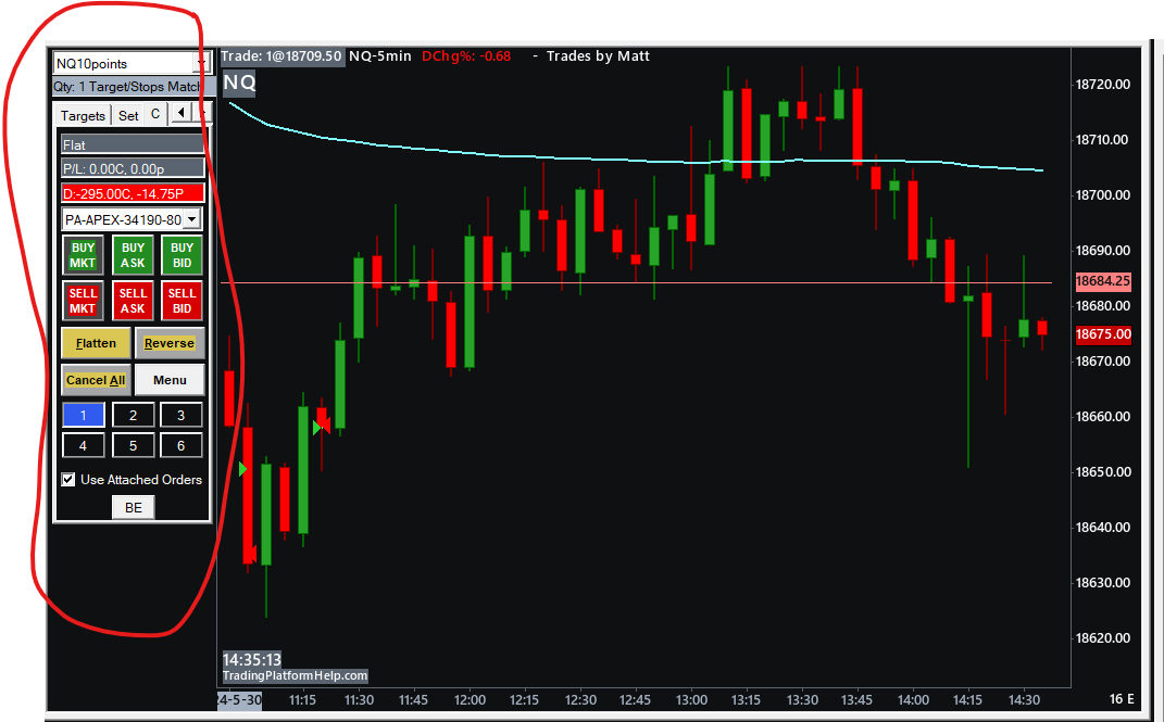

alexkim1211 - Posts: 9
Yes i am using the trade window... not control bar. i attached a picture of what i mean.
on the blinking i saw a previous support ticket on the support board saying its microsft dialogue windows and that i neeed to download current version which i did. but its still blinking.
Turning off graphics setting doesnt work.
imageTrade window 1.png / V - Attached On 2024-05-30 18:35:59 UTC - Size: 64.9 KB - 318 views

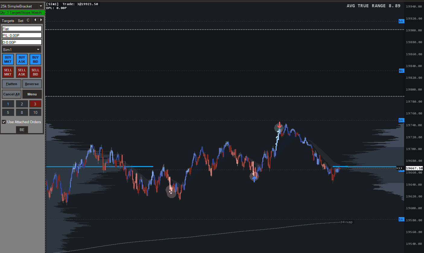

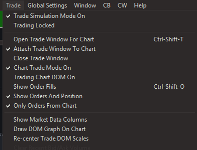

i have the same issue...
trade > attach trade window to chart
the trade window will shown attached.
My problem is I cant show it floating. When I uncheck the attached trade window, the trade window just disappears. (even with the chart tade mode on is checked)
Date Time Of Last Edit: 2025-03-15 20:37:04

[2025-03-17 13:39:44]
John - SC Support - Posts: 48139
When the Trade Window is attached select the option for "Trade >> Attach Trade Window to Chart" to make the window float.
If the Trade Window disappears when you do this, then that means that the Trade Window is setup to display somewhere off screen. In this case select "Chart >> Reset Child Windows". Refer to the following:
Chart Menu: Reset Child Window (Chart menu)
