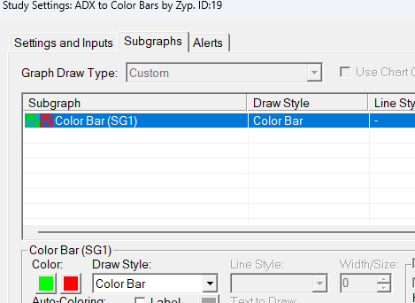

I ahve a study ADS to color bars which has only 1 subgraph but has 2 colors red and green.
I would like to use this subgraph in an other formula but i can't determine which formula can help me highligh when a bar is red or green, i tried some things like ID19.SG1>0 or <0 or with 1.
Do you know how to do this ?
I attached a screenshot of the subgrpah window.
Thanks and regards
imageCapture d'écran 2024-05-30 213952.png / V - Attached On 2024-05-30 14:41:52 UTC - Size: 14.59 KB - 288 views
[2024-05-30 15:04:11]
You can not use a Coloring itself in an alert condition. You need to use the actual underlying information for why it is being colored one way or the other.
We can not tell you how the coloring is being done. You would need to check with the creator of the study for this information.
