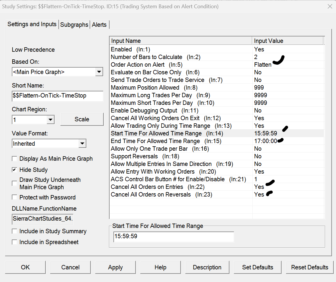

[2024-06-13 03:16:16]
User61168 - Posts: 491
This is SC delivered solution to flatten trades at a specific time. Works great in replay also :-
Edit: In the Alert box, just put ID7.SG1<>0 where id7 is position qty
Date Time Of Last Edit: 2024-06-13 03:17:37

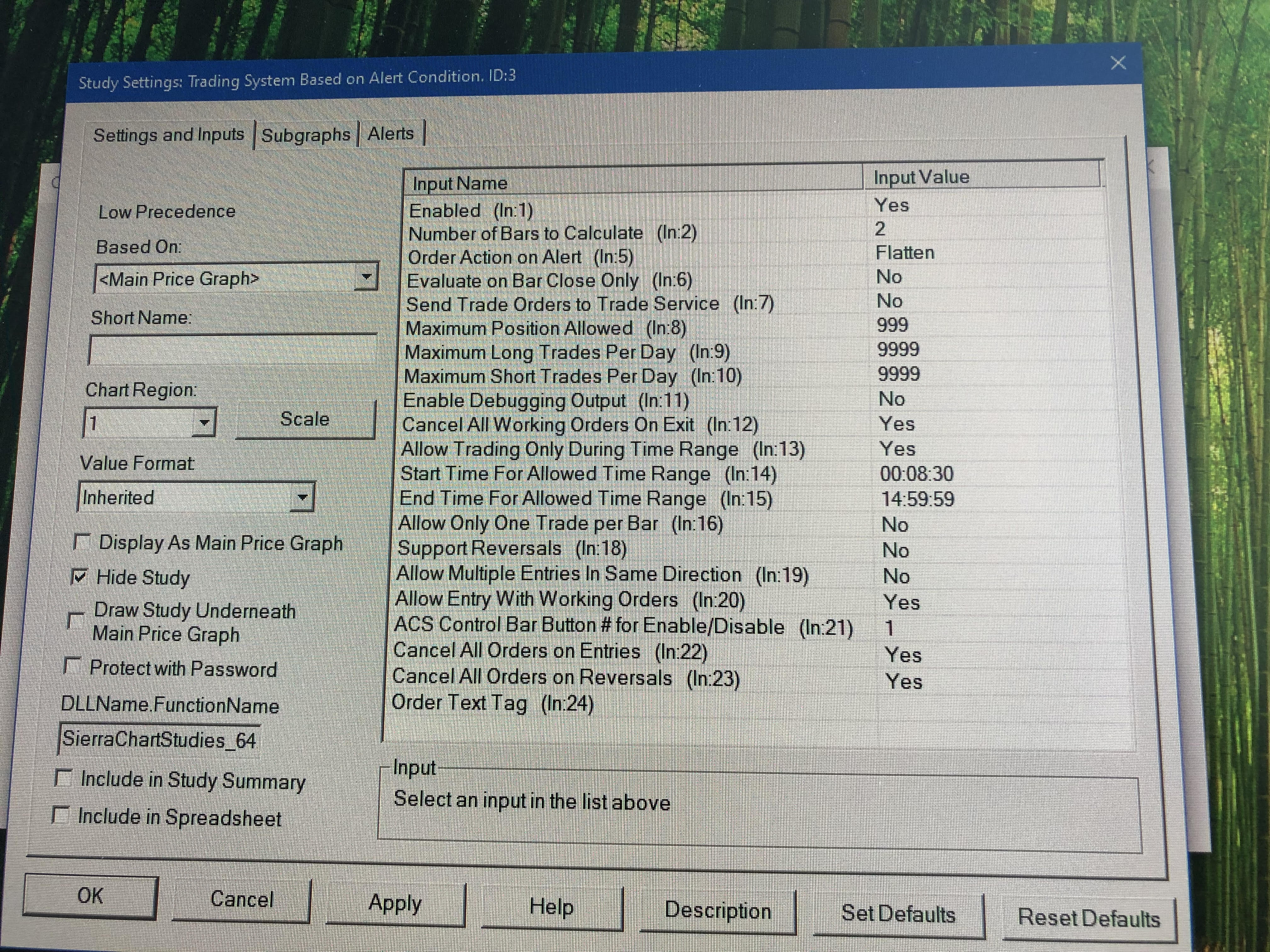

[2024-09-08 16:06:03]
User509533 - Posts: 99
In the custom study/DLL provided by Sierra Chart (SierraChartStudies_64.dll), I am unable to locate the $$Flatten-OnTick-TimeStop study as mentioned in the last post. Can you help me understand what I might be doing wrong?

[2024-09-08 18:47:04]
Add the study mentioned here>>> Trading System Based on Alert Condition
The SC document is not updated. This study now supports buy entry, but exit, sell entry, sell exit AND FLATTEN. Select Flatten, specify what time duration you want to flatten and that’s about all that is required.simple and elegant one simple alert study to code all the flatten/closeAll needs.
[2024-09-08 22:31:23]
Thank you for your assistance! However, the issue persists— the trade is still not flattening after 3 PM CST during the back-test. I'm unsure what the correct alert condition would be in this case. Additionally, the condition ID7.SG1<>0 is returning an error.

[2024-09-09 01:29:34]
1) Time duration is set incorrectly in the screenshot. It should be 15:00 16:00 assuming the timeframe on your chart is set to central time zone.
2) Replace ID7.SG1 with whatever you have for “Trading:position quantity” study.
3) Make sure you have data in your chart atleast a minute after 13:00
4) if you only trade manually then please be careful with these two settings as it is required to enable Trade>Autotrading enabled global and chart. Both should be checked
5) trade > Trade simulation mode on is checked
6) trade > trading locked is unchecked
Always ensure #5 is checked.
