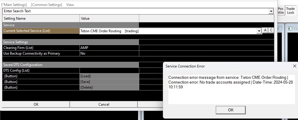

[2024-05-28 14:14:03]
User61576 - Posts: 458
I spoke with amp and they moved me
though as you can see, I am getting an error
pls advise what i am missing here
