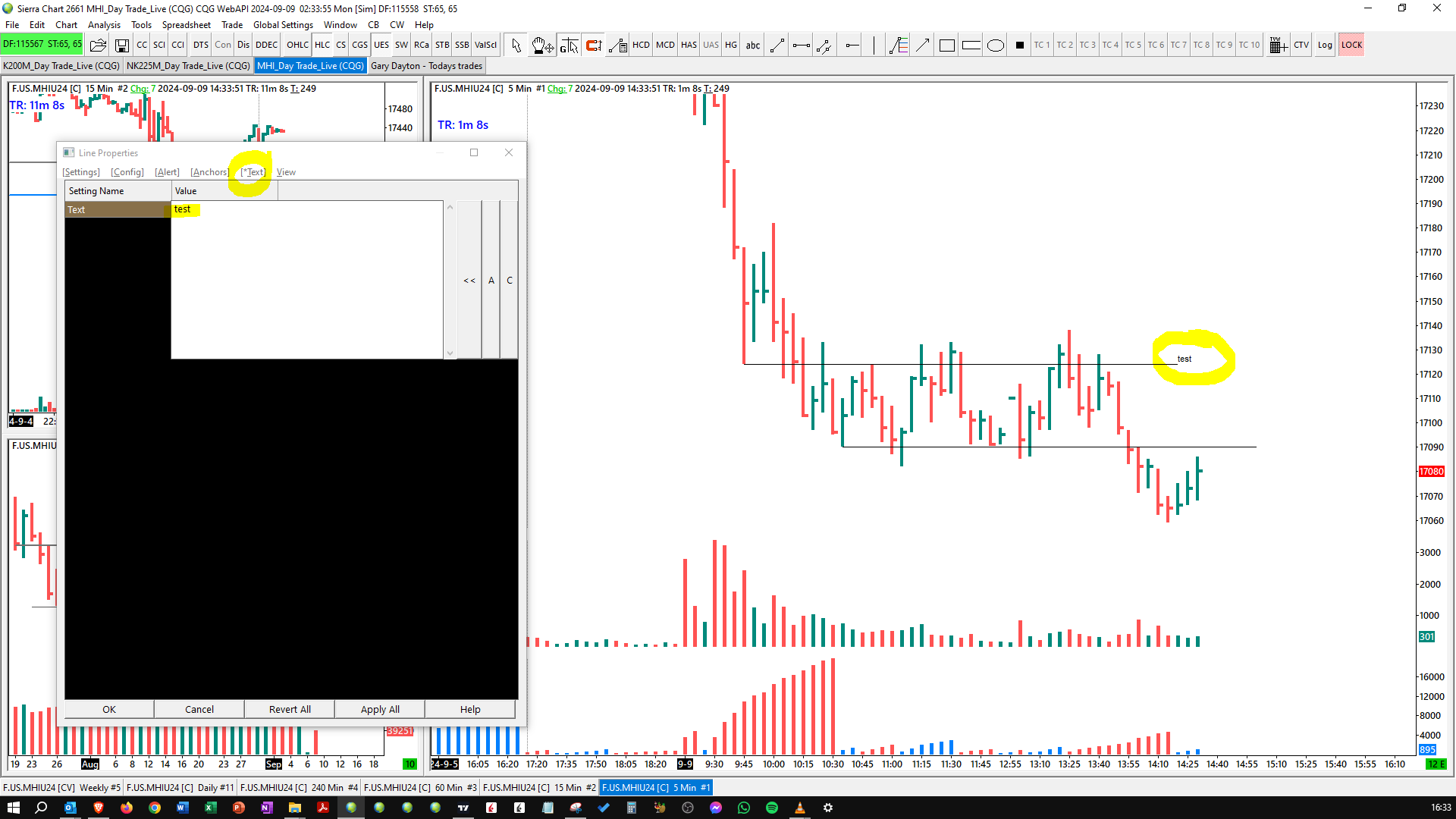

| [2024-09-09 06:35:38] |
| User629461 - Posts: 213 |
If you draw a line and right click to open 'chart drawing properties' dialogue box, you'll see the 'Text' tab - see pic attached with example using 'test' text

| [2024-09-09 06:41:25] |
And, it looks as though its only enabled for line drawings - other drawings still have the old dialogue box style
