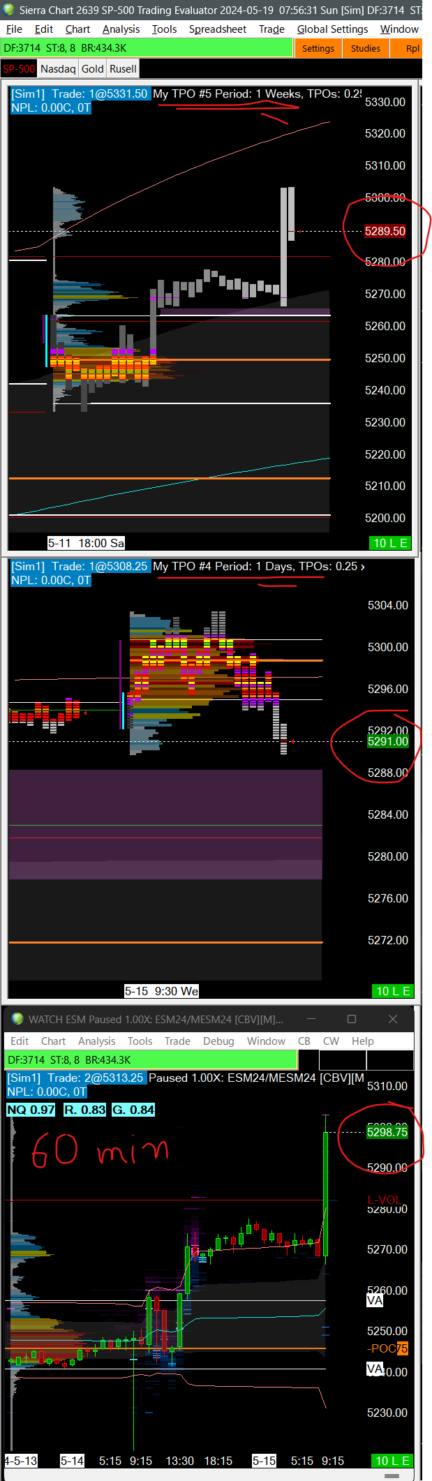

Please take a look at the attached screenshoot, left is TPO (period Day, 1 min) and right is footprint (range per bar 14 ticks)
At the beginning of the evening session the TPO started to show wrong price as marked in the picture.
Please help me to understand what wrong settings I do have, I bet the TPO (or the chart) is not set properly.
PS. noticed this issue during reply mode
Date Time Of Last Edit: 2024-05-19 11:27:33
imageTPO wrong price.png / V - Attached On 2024-05-19 11:23:37 UTC - Size: 481.27 KB - 267 views

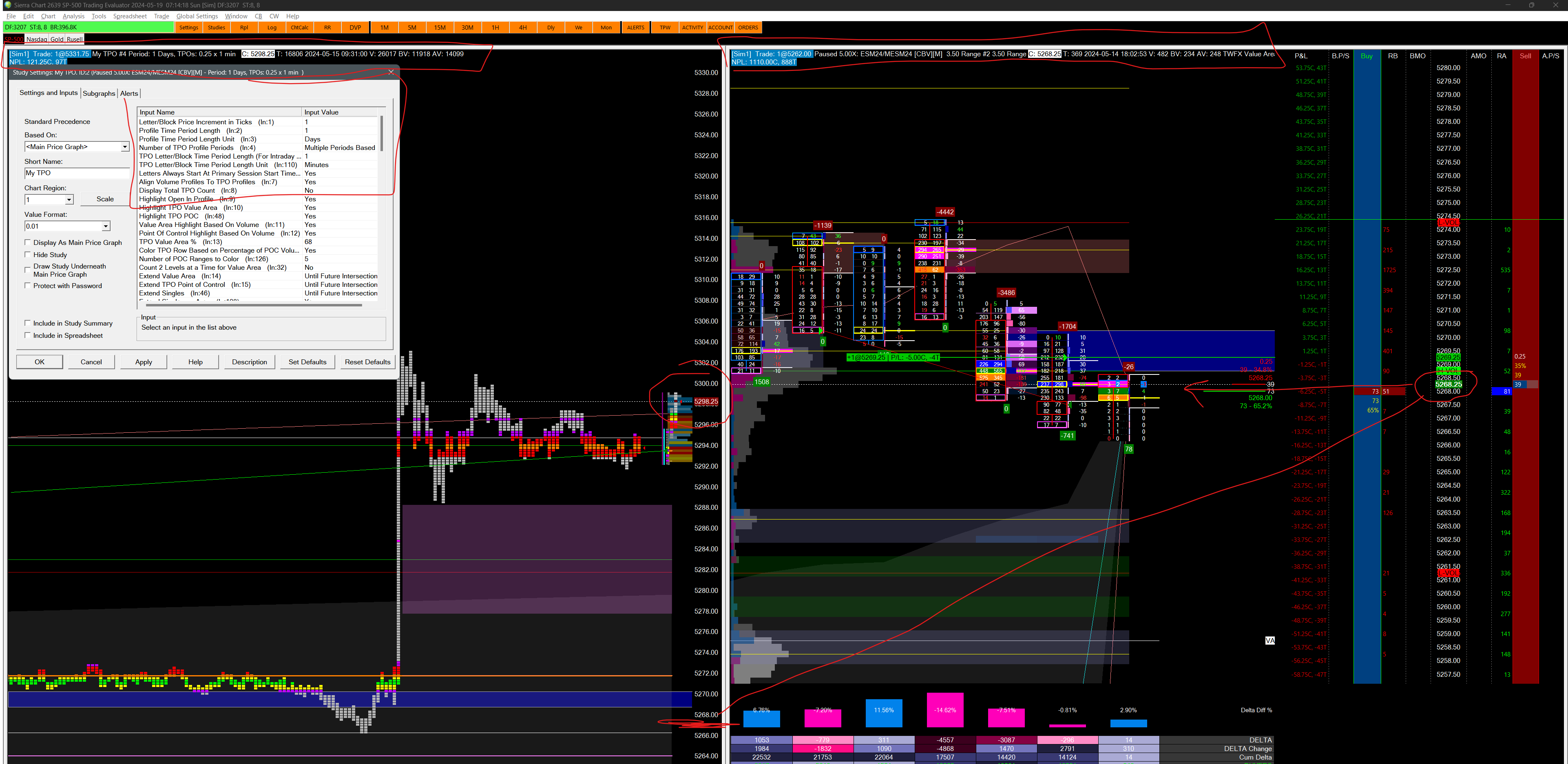

another attached, 2 TPO(1 day, 1 week) and 1h chart
During the reply mode!
imageTPO wrong price2.png / V - Attached On 2024-05-19 11:59:27 UTC - Size: 119.07 KB - 209 views

In the first image, the charts are not synchronized. In the Chart Headers, the time of the bars displayed furthest to the right (we do not know if your charts are fully scrolled all the way to the right or not, since we can not see the information from the bottom right corner), show the following:
- Left Chart: 2024-05-15 09:31:00
- Right Chart: 2024-05-14 18:02:53
We have to believe the same is true for the other image, although we can not see the times in that image.
Refer to the following:
Replaying Charts: Preventing Loss of Synchronization Between Different Charts During Replay

the charts were fully scrolled all the way to the right.
i restarted the reply and worked correctly so I believe there are some sync issues during the replay.
the second picture was taken after I restarted the reply so I noticed the de-synchronization, again.
