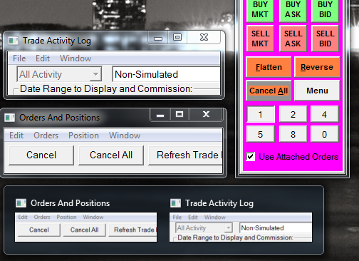

Today this happened again, including a second time after a reboot. Here is a pic of the result. I get the detached trade window, 'trade log' and 'orders and positions' windows but the main Sierra window is gone as you can see from the bottom part of the pic where I am hovering over the Sierra shortcut on my taskbar showing what windows are available. Also note that the Sierra program icon, which is usually next to the name of the window in the title bar has been replaced with the default program icon from Windows. The only way to correct this is to kill the process with the Task Manager and re-run the program.

We have no solution for this. This must be a system issue on your side.
We recommend a full and fresh reload of the operating system on your computer.

So you are detaching a Trade Window from one of the chart windows which is part of the main Sierra Chart window?
We see no reason why this would matter, just wanting to get a better understanding.
Sierra Chart uses what is known as a Multiple Document Interface which is not commonly used. So we suspect something is going wrong with that at the operating system level.

Yes. If I select 'Open Trade Window' from a chart attached to the main window then the main Sierra window disappears. As a test, I also detached the chart first from the main window and selected the same command from there and it made the detached chart disappear instead. So it seems to be whichever window the command to open the trade window comes from is the one that disappears.
I have found a work around for now. If I select 'Attach Trade Window' instead of 'Open Trade Window', to make it attach to the chart first, then I can select it again (or rather deselect it by un-checking it in the menu) and it will detach from the chart without anything disappearing. So I don't think I ever need to actually use 'Open Trade Window' anymore.

There can be no doubt, that this is an operating system issue. We have never heard of anything like this.
It is very easy for you to demonstrate that it is an operating system issue. Test Sierra Chart on another computer system. This will not happen.
