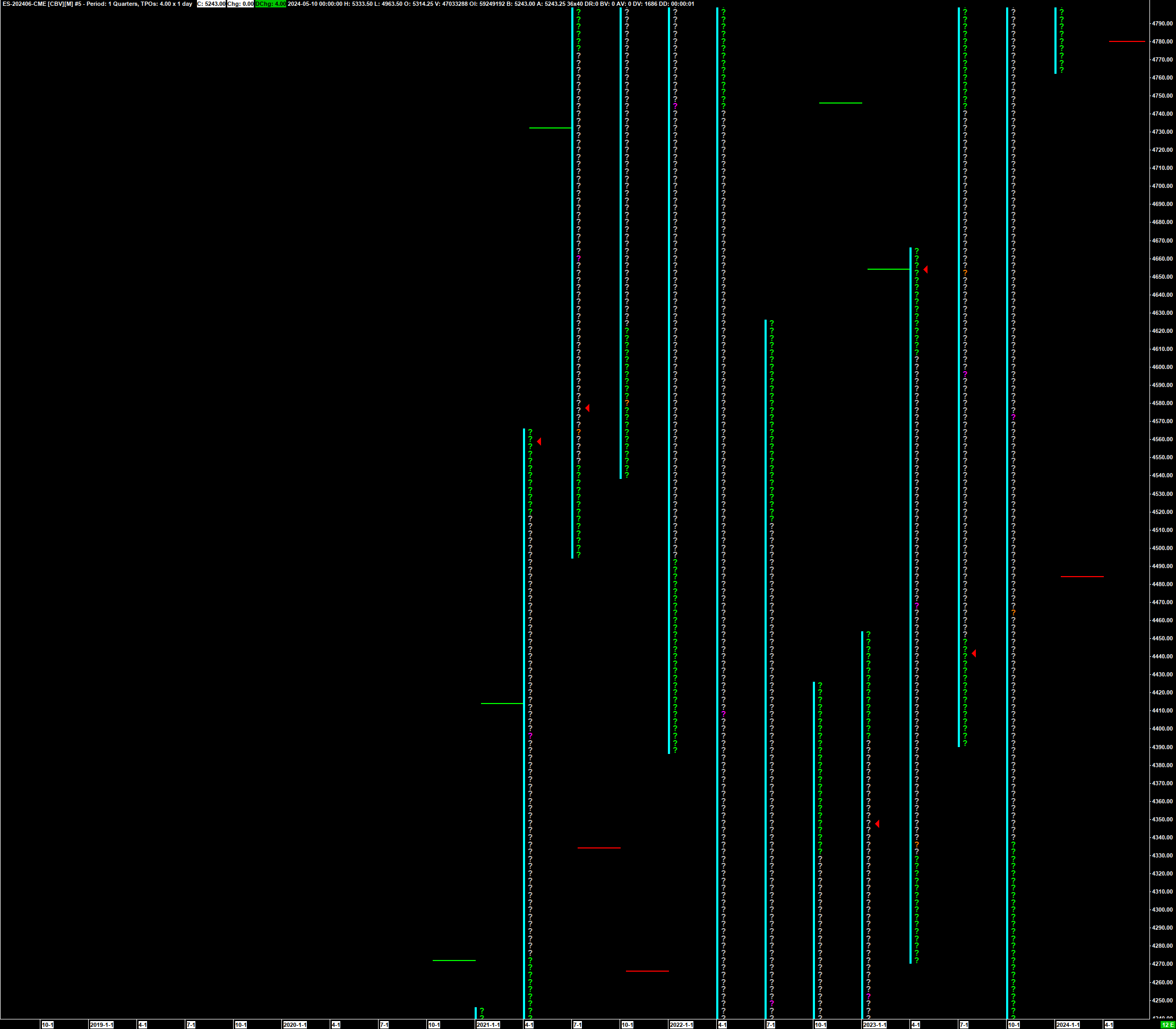

SC 2634 Symbol: ES, volume-based rollover - back adjusted Base chart: Historical, daily Study: TPO, quarterly current study settings (the problem is also with any other choice of settings): 16 tick increment, letter Resulting chart displays only one column per period and all letters are question marks: https://www.sierrachart.com/image.php?Image=171529293414.png There is no problem when using yearly, monthly, or weekly profile time period lengths. The problem just shows for the quarterly TPO chart. |

We can reproduce this, so there does appear to be some problem with the quarterly selection. We will look into this.

We need to implement support for the quarterly period. We will do that.

No support for this yet, but what you can do is use Period Time Period Length = 3 (months)

We are not seeing any issue with this. If you have a problem provide that chart by following the instructions: Support Board Posting Information: Providing Chartbook with Only a Single Chart This is what we see when using Quarters and the same configuration as the first post: https://www.sierrachart.com/image.php?Image=1731947013485.png Sierra Chart Support - Engineering Level Your definitive source for support. Other responses are from users. Try to keep your questions brief and to the point. Be aware of support policy: https://www.sierrachart.com/index.php?l=PostingInformation.php#GeneralInformation For the most reliable, advanced, and zero cost futures order routing, use the Teton service: Sierra Chart Teton Futures Order Routing |
