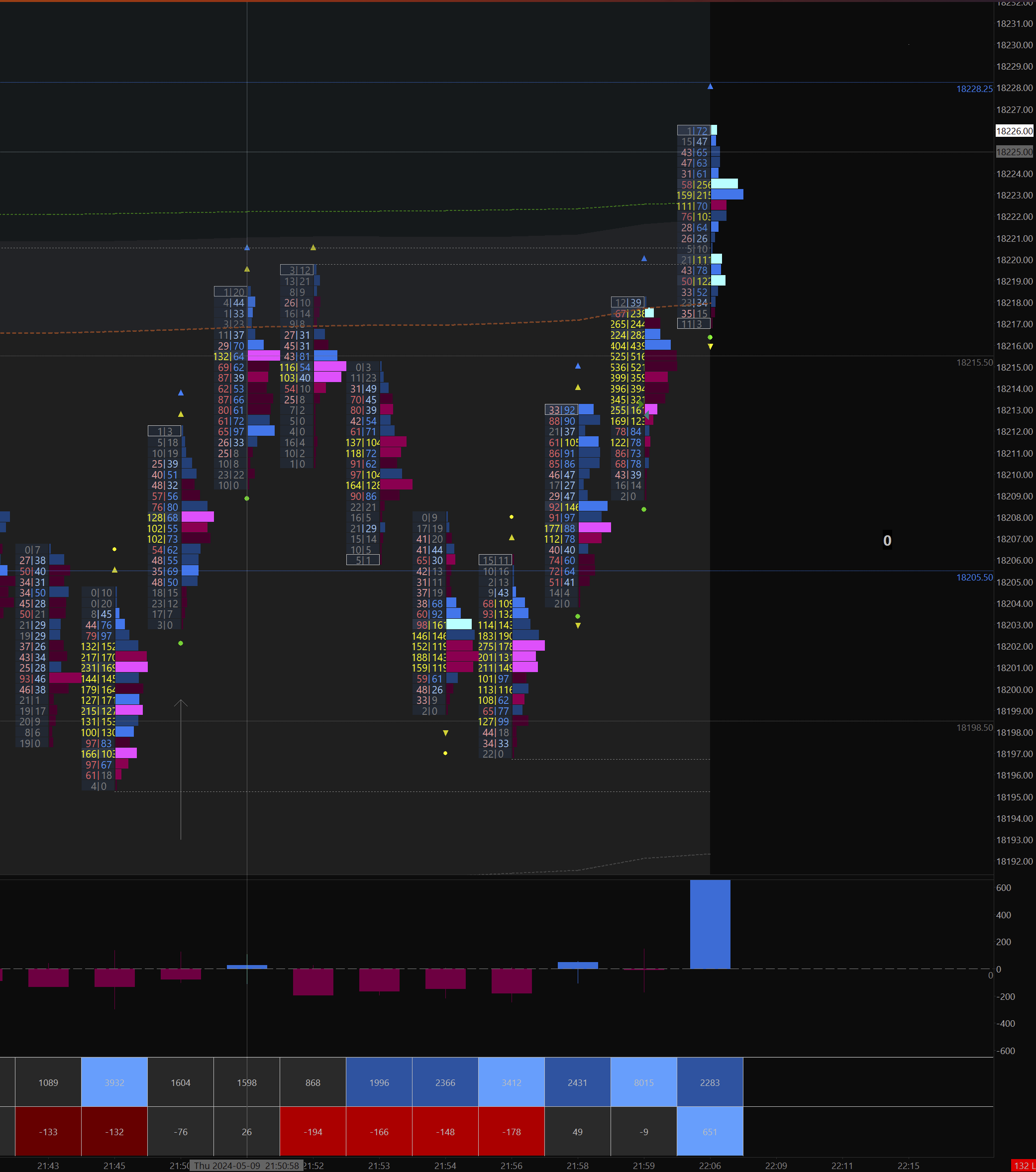

Thanks John, that is helpful information. Here is a more detailed example and explanation of what is happening repeatedly, including the available message logs.
In the first image, the bar with the large white arrow (bar time 21:50:00) has a blue triangle (generated by the Color Bar By Alert Condition study) and a green circle, generated by the Trading System by Alert Study - both of them have identical code, and as you can see, both are "True" at the time of bar close, 21:50:58.
This second image is is a screen shot taken 13 seconds later of the alerts log (left) and the trading services log (right); the alerts log shows that the Trading System studied fired a "True" signal at the bar close 21:50:58, and still no trade was initiated. Meanwhile at the same time, the Trade Service Log shows no indication of why this signal has not been processed. There are no further messages in the Message Log either; the Trading System study is set to send trade orders to trade service and I am using Trading Evaluator on live market data.
I would appreciate any further insight you can offer into this matter, as I believe I have pretty throughly exhausted the available options I can think of.

[2024-05-09 21:07:49]
Please get us your chartbook so we can take a look. Let us know what chart number has the trading system on it. Follow these instructions to get us your Chartbook:

Everything is working properly for us in the chart, with a few tweaks. But here are a few items of note:
1*. We moved the Trading System Based on Alert Condition studies to the bottom of the list of studies. Since there is a dependency on the Numbers Bars Calculated Values, it needs to be lower in the list than the studies on which it depends. Putting it at the bottom is safest. This is the most important item.
2. We removed all the other extraneous studies. We do not think this will have any impact, but given how many studies you have on the chart, and how you only really need a couple for the trading system, we would recommend offloading everything that you do not need. It could be causing a longer time for the study to get calculated and create some kind of timing issue. Again, we do not think so, but best to start simple and go from there.
3. We only tested in replay. We do not think it will make any difference, but just so you are aware.
We did not have any issue with Enabling the Trading System within a bar after the condition is true. It would properly place the trade when the bar closed as long as the condition was true at bar close.
