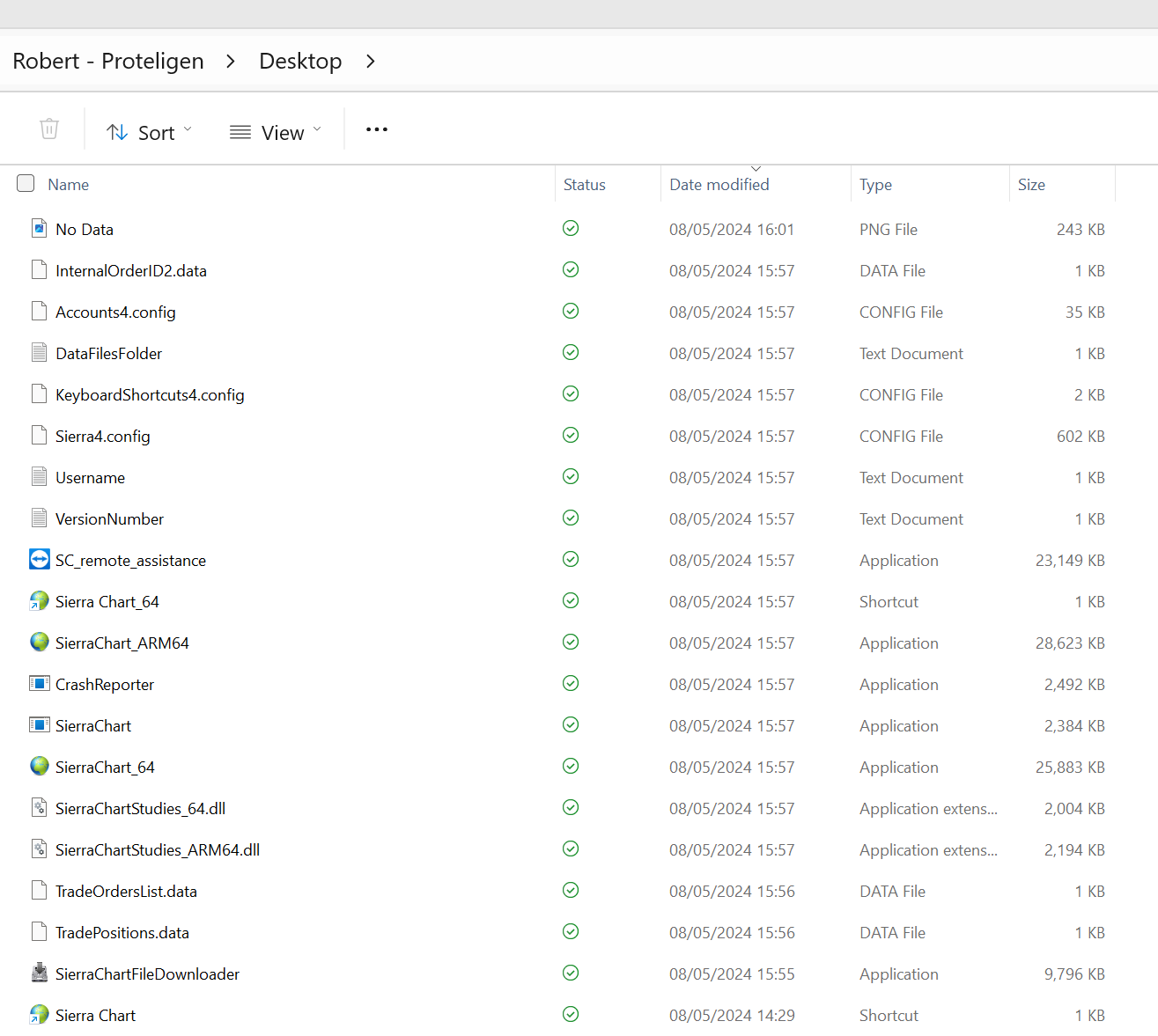

John, thanks for the response. To be honest I think I did something really stupid. I may have dragged the icon from the folder onto the desktop thinking that would create the shortcut. So, in the folder now the only similar looking icon I have is SierraChart_ARM64
[2024-05-08 15:17:53]

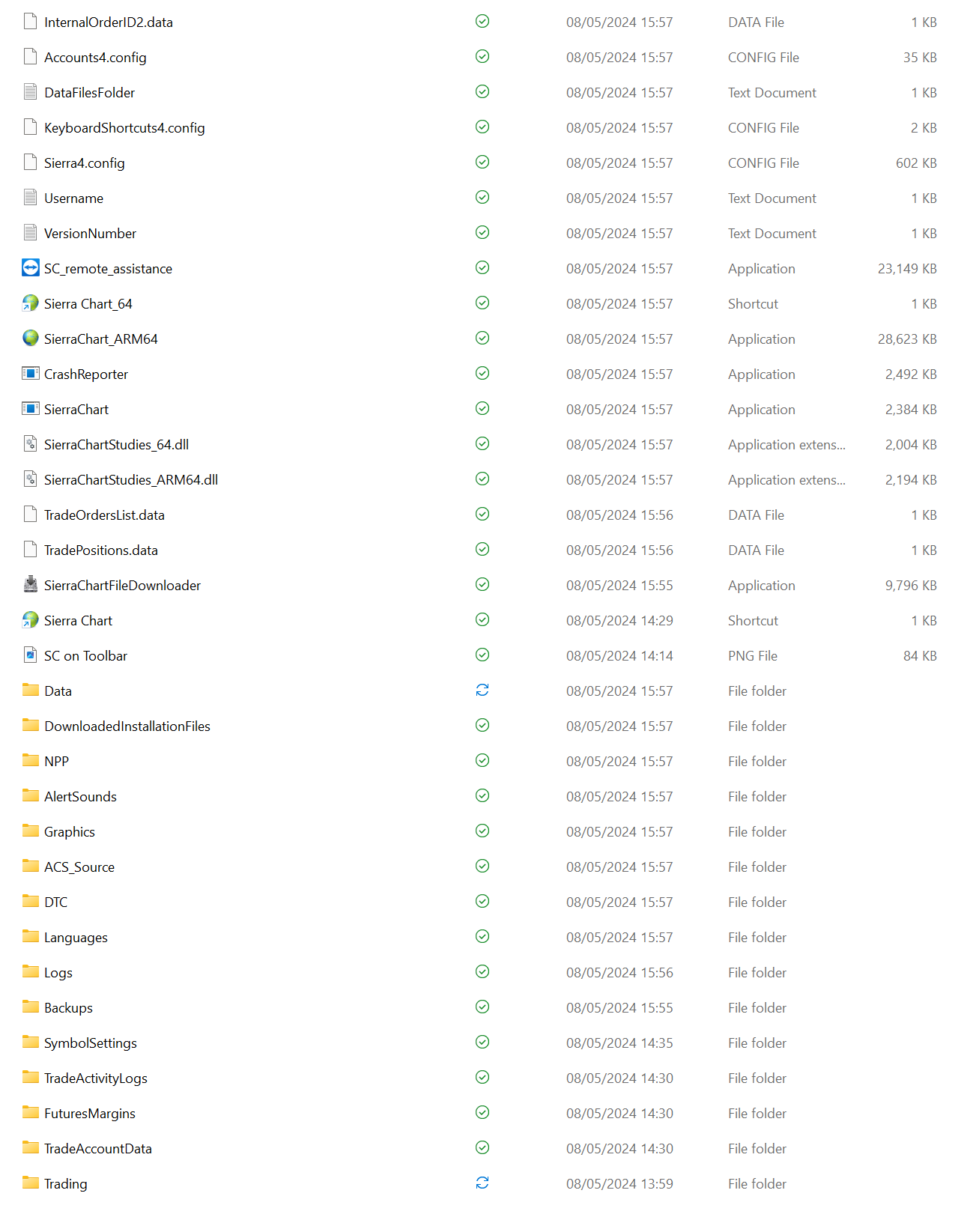

bobstone249 - Posts: 61
I also have a number of other folders on the desktop which I believe appeared as a result of my actions. The only thing I can see when looking into all the other folders ion SierraCharts is SierraChartsInstance2 folder > SierraChart_64 (Application)
Date Time Of Last Edit: 2024-05-08 15:28:16
imageScreenshot 2024-05-08 162007.png / V - Attached On 2024-05-08 15:21:00 UTC - Size: 117.35 KB - 308 views
[2024-05-08 15:25:58]
It looks like you moved the entire Sierra Chart folder to the desktop. Do you know which of your Sierra Chart folders this is from? If so, then you can simply move the files back to that folder. Sierra Chart is setup to be portable, so this is not really a problem.
The most important file in that list is 'Sierra4.config' as that has your global settings in it. If you can at least get that file put back in place, then you can re-install Sierra Chart into the same folder using our installer and you will be fine.
Note that we do not see any folders in the list, so we assume these did not move as well, so your 'Data' folder should still be in the same location as before. If this is not the case, then you will want to make sure you move the 'Data' folder back to the appropriate Sierra Chart folder.

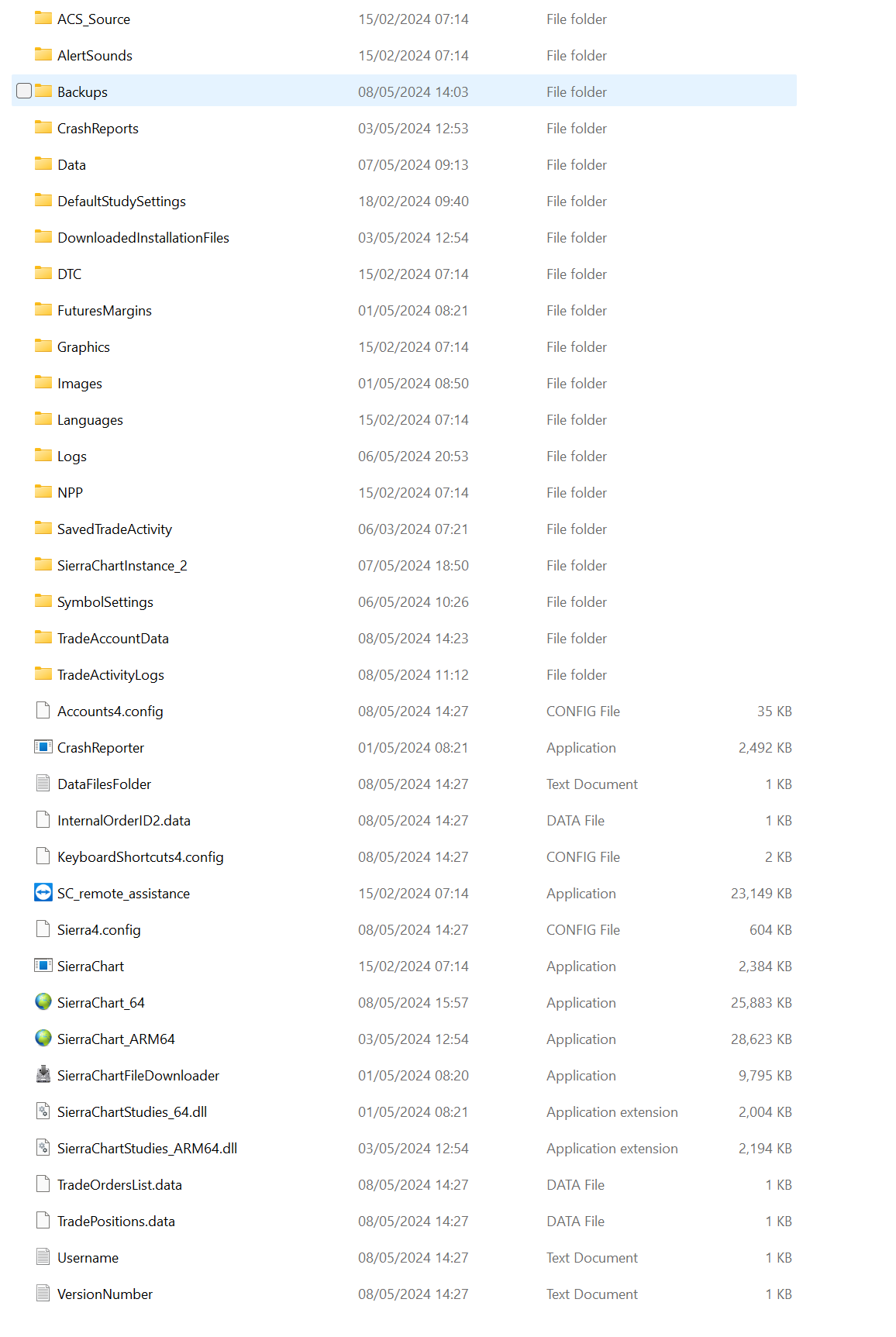

[2024-05-08 15:49:40]
John all the folders and the files that were in the main SierraCharts folder were "copied" to my desktop. All the original files remain in the original folder including 'Sierra4.config'. For now I've moved back SierraChart_64 as I would be duplicating everything otherwise.
What's my next move? Reinstall Sierra Charts, then look to create the desktop shortcut?
If so, how do I re-install? Just conscious that I have 2 Sierra Charts on my computer, one for Broker, one for Prop. I have uploaded another image showing SierraCharts folder with all the files in there.
