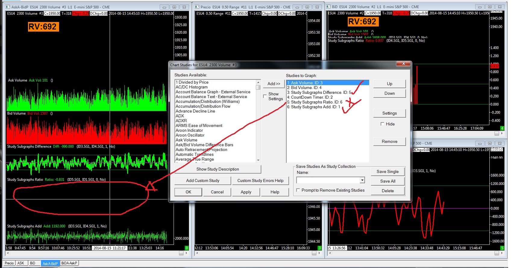

I am charting 3 formulas:
number 1: difference: ASk - Bid: chart ok
number 2: Add: Ask + Bid: chart ok
number 3: Ratio: number 1 / number 2: fail
as you can see in the attached file, there is a mistake and the platform, it doesnt chart my formula. help me to solve this.
thank you
imageSin título.jpg / V - Attached On 2014-08-16 22:54:38 UTC - Size: 479.85 KB - 618 views
[2014-08-17 01:09:12]
Sawtooth - Posts: 4357
The problem has to do with calculation precedence.
In the Studies to Graph list, move the Study Subgraphs Add above the Study Subgraphs Ratio.
[2014-08-17 01:38:56]
julian pineda - Posts: 60
it doesnt make any difference.
[2014-08-17 01:45:40]
I started all over and works¡ thanks a lot
[2014-08-17 11:10:22]
This is correct. The issue has to do with the study calculation precedence. Refer to the documentation about this here:
Chart Studies: Study Calculation Precedence And Related Issues
