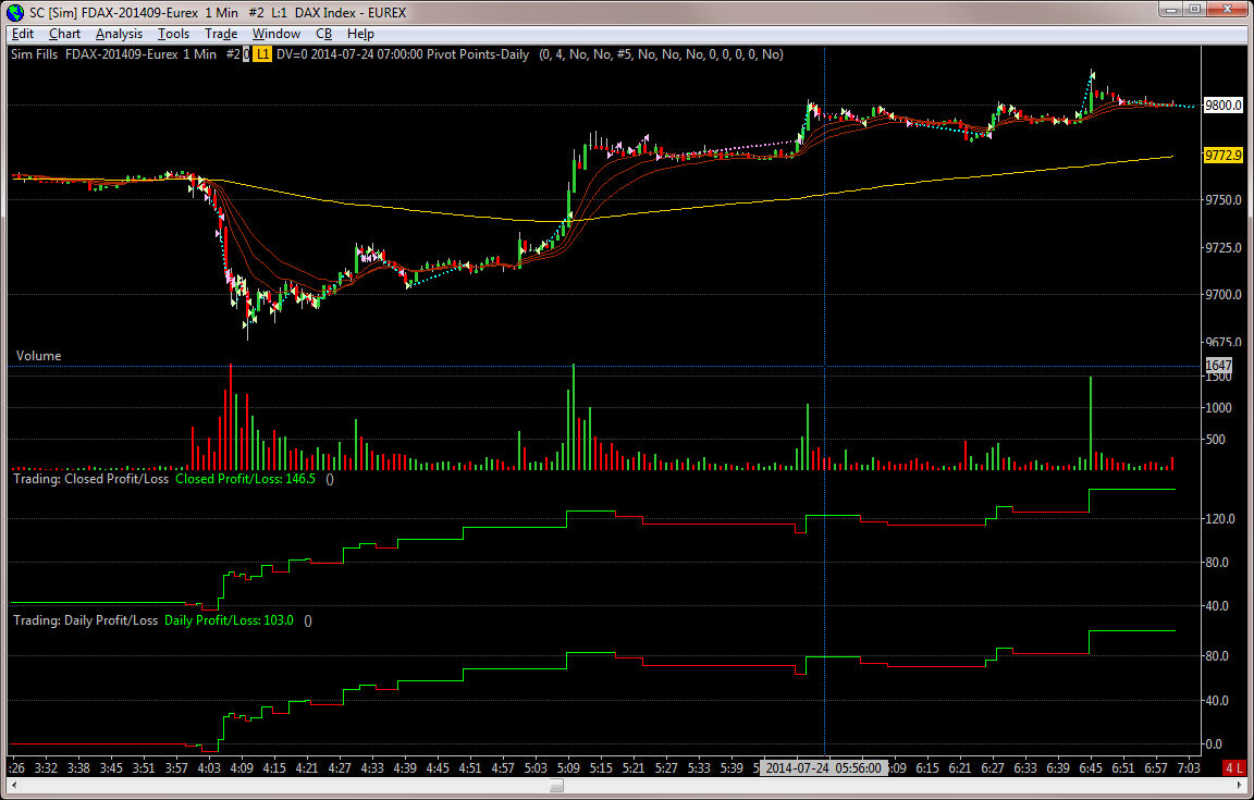

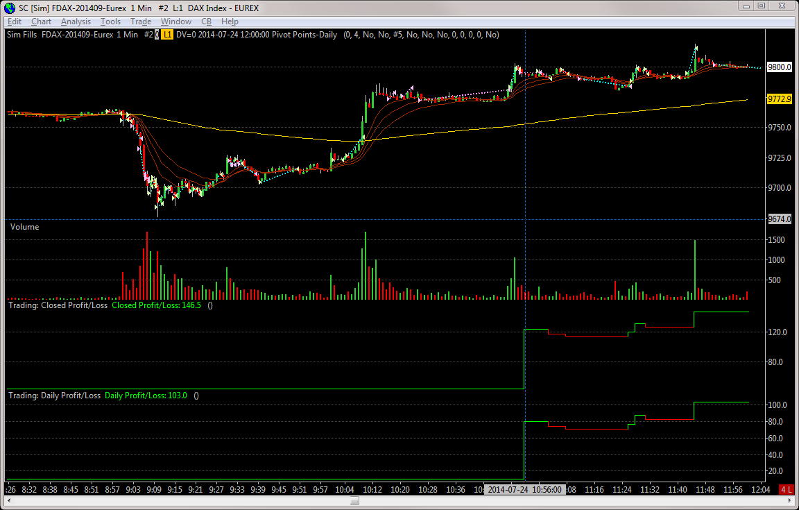

1.)
I guess there could be a bug regarding time zones in the two studies Closed Profit/Loss and Daily Profit/Loss.
Description:
First, I have trades on the chart, but they seem to be ignored by the studies Closed Profit/Loss and Daily Profit/Loss.
Then, I realized that my trades are ignored only in the morning until an imaginary time border at about 11 a.m. every day.
Please see the attached image ProfitLossUTCplus2_20140816.png.
I checked the following:
My Daily Stats Reset Time is set to midnight.
My session time goes around the clock. Changes in session time have no effect.
But if I change the time zone by one hour the imaginary time border shifts by 2 hours.
So, after changing the time zone from UTC+2 to UTC-3 I can see all my trades in both studies.
Please see the attached image ProfitLossUTCminus3_20140816.png.
Background info: The example above was taken from fdax future trades at the Eurex, opening from 8 a.m. to 10 p.m. CEST (=UTC+2).
Could you please have a look a give me feedback. Maybe I missed only a config item.

imageProfitLossUTCplus2_20140816.png / V - Attached On 2014-08-16 11:04:27 UTC - Size: 45.12 KB - 580 views
imageProfitLossUTCminus3_20140816.png / V - Attached On 2014-08-16 11:04:37 UTC - Size: 50.42 KB - 571 views

1. We have the problem now solved. There was a significant amount of work to debug and correct the issue.
Version 1176 which resolves this will be out later today.
[2014-08-22 17:12:11]
AC95575 - Posts: 4
Thank you very much. I just checked it out and it works perfectly. :)
