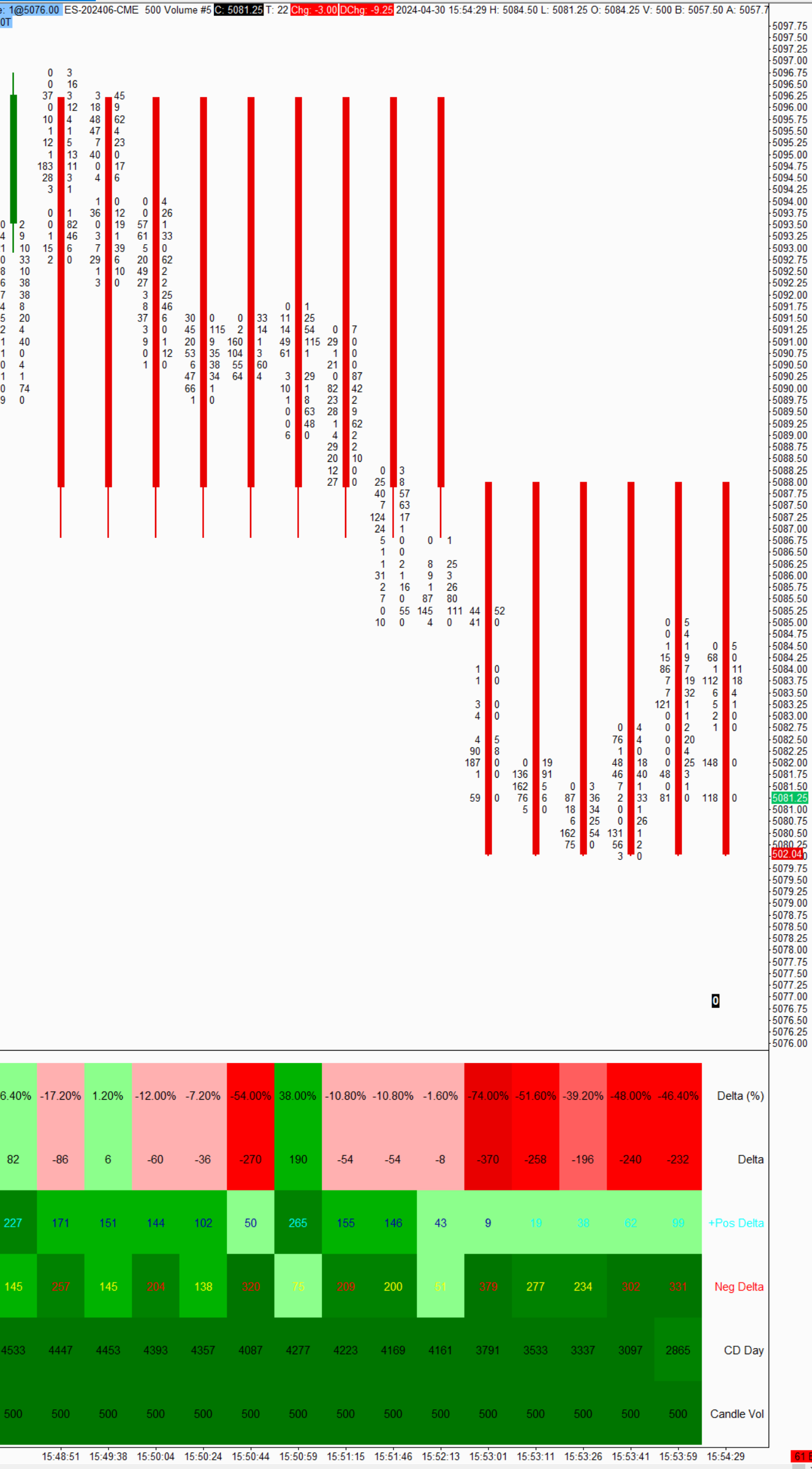

1) I am looking to add an alert to a Footprint chart that would trigger when Delta on a bar is over a certain value but price is stagnate and unaffected by buyers/sellers at that level.
For example if Delta> 150 and price on ES has not moved up more than 3 ticks.
I've attached a screen shot and bar @ 15:50:59 is the bar I am looking to trigger an alert for if anyone has a better formula solution so that I am automatically alerted of absorption occurring.
2) I have recently switched to a bar by volume chart and I am getting these large candles that are not aligned with the DOM/bid ask values as shown in the picture, any advice on how I can have these more accurately aligned?
Thank you in advance!
imageES chart.PNG / V - Attached On 2024-05-01 00:44:16 UTC - Size: 437.64 KB - 2572 views
[2024-05-01 14:34:38]
1. You would need to use the "Volume at Price Threshold Alert V2" to get the information when there is a delta over a certain value. You would then combine that with a check of the price to see if it within the range you want. For example, you would use a formula like the following to test if the price is within 2 ticks of the first alert from the Volume at Price Threshold Alert V2:
=AND(ID1.SG1, C > ID1.SG1 - TICKSIZE * 2, C < ID1.SG1 + TICKSIZE * 2)
You would then need to add an OR function and test additional Volume at Price Threshold Alert V2 triggers.
If there is the potential for a lot of triggers to occur within a bar, then you might want to consider using the Spreadsheet System for Alerts instead.
2. You are overlaying a time based chart to get the bars. You need to overlay the Main Price Graph from the same chart to get what you want.

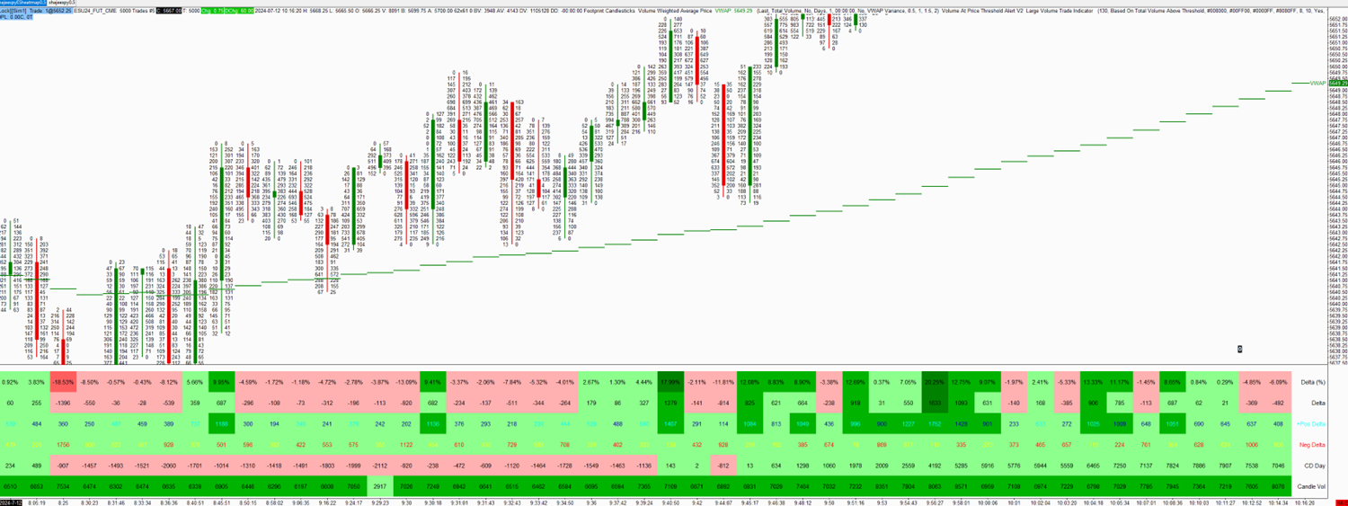

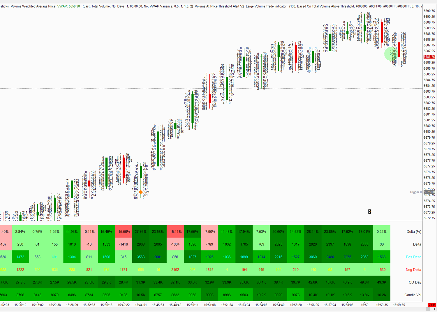

After using footprint charts with John’s recommended formula I am reaching out to the community/or John to see if I can get some assistance in modifying it to show me accurate levels of absorption. I am currently using a 5000T footprint chart and since switching over to Denali data feed over the IBKR data I am getting more accurate data which I can finally rely on.
My question is how would I go about modifying the formula or where can I understand where and what each part of the formula means(I am currently not using an OR function as I don’t know how to.)
I’ve attached a screenshot, in specific 9:16:22, 9:30 and 9:34:50 candles seem to be red candles with buying pressure creating wicks pushing price back up even though delta is negative price is holding firm. I would like to get a trigger a symbol/alert on the chart which I have currently but not sure under what conditions it is currently being trigger, this week it showed up once where a large order on the ask side appeared 15:44:01 on the second screenshot. This was a helpful trigger as price quickly ran up I’m assuming because this was someone hitting the ask with a large order, I activated the trigger symbol on the absorption v2 study and this showed up but I don’t see where I can meddle with the settings for this to trigger more often.
What I am ultimately looking to have/replicate is what this trader is using on ninja trader which he has told me is possible and probably even better on Sierracharts
He is saying that a computer churns a massive amount of tick data and outputs the absorption levels. (I’m guessing DOM or footprint data?) These levels can be exported to a platform and be presented in the form of an indicator that draws these lines. (I am okay with this being displayed right on the footprint chart) He uses strong orderflow absorption level that is detected by an algo and is timeframe independent (as it is based on volume and not time)
If anyone uses something like this in their own trading can you please help a fellow trader out with this issue I’ve been racking my brain over?

imageIMG_0610.png / V - Attached On 2024-07-14 01:26:04 UTC - Size: 443.21 KB - 1050 views
imageIMG_0613.png / V - Attached On 2024-07-14 01:42:07 UTC - Size: 555.09 KB - 4521 views
