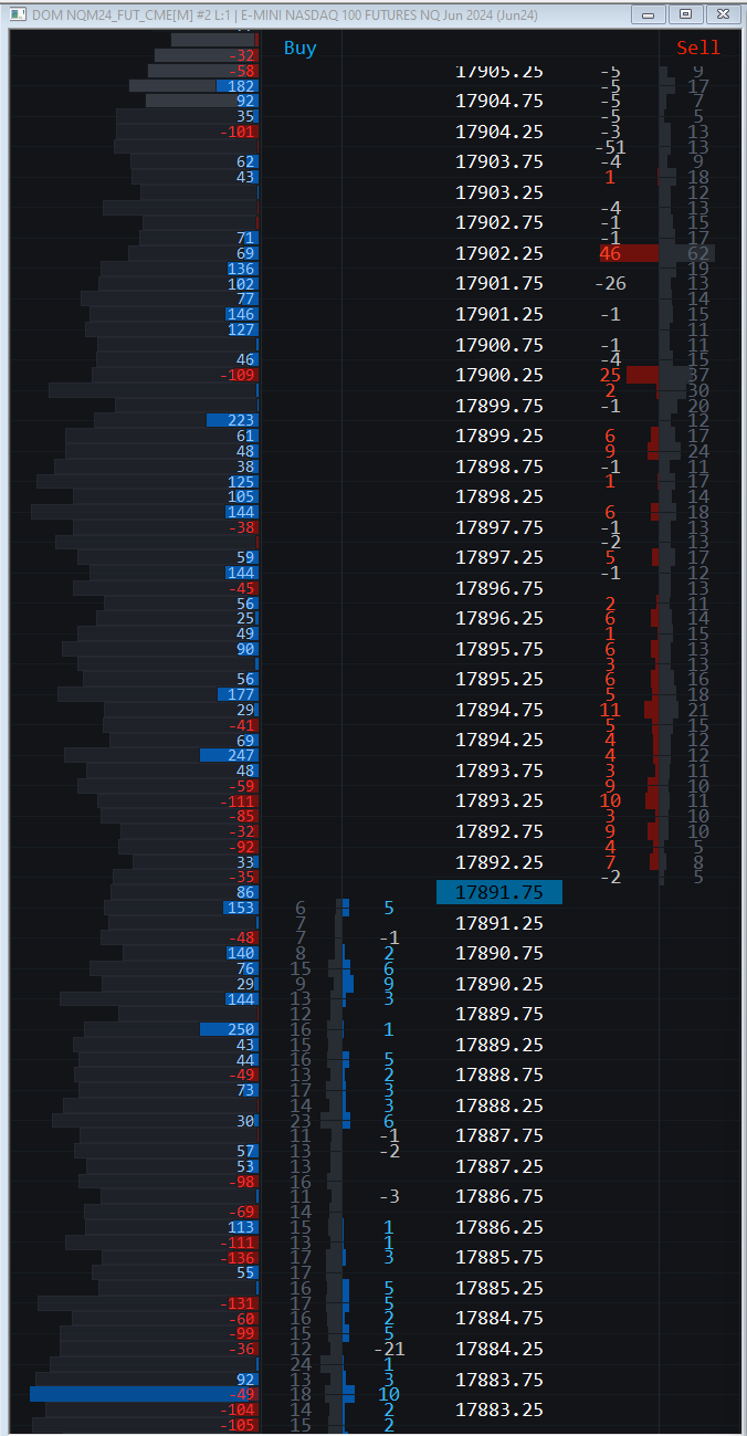

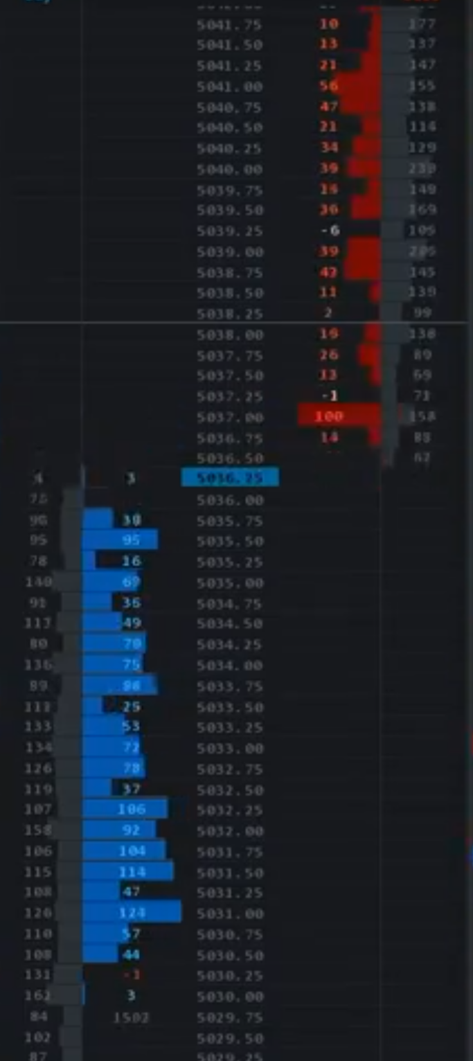

I would like to adjust the width of the delta bars on either side of the price ladder in the DOM to be wider so it's easier to see where participants are getting positioned.
The way I have it set right now, the bars are so compressed, so visually, it's difficult to draw any clear conclusions about what is going on.
Is there a setting I can adjust to make the delta bars wider on the price ladder in the DOM without making the window displaying the DOM wider?
I have attached two screenshots. The first shows how I would like the DOM to look. The second shows what my DOM currently looks like.

[2024-04-29 18:30:26]
Refer to the following setting:
Global Trade Settings Windows: Maximum Volume Bar Width Percentage (Global Settings >> Chart DOM Settings >> Other >> Other Settings)
Note that regardless of what you change this to, the size of the volume bars is going to be relative to volumes in that particular column and the greatest volume could be off the screen, so you may have "skinny" bars just due to the a large volume somewhere above/below the current view.
