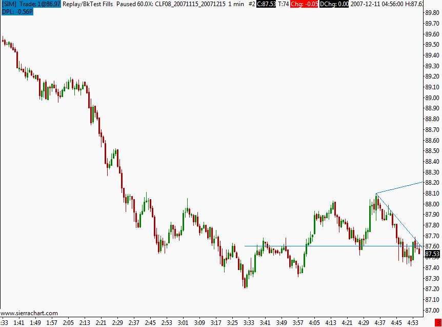

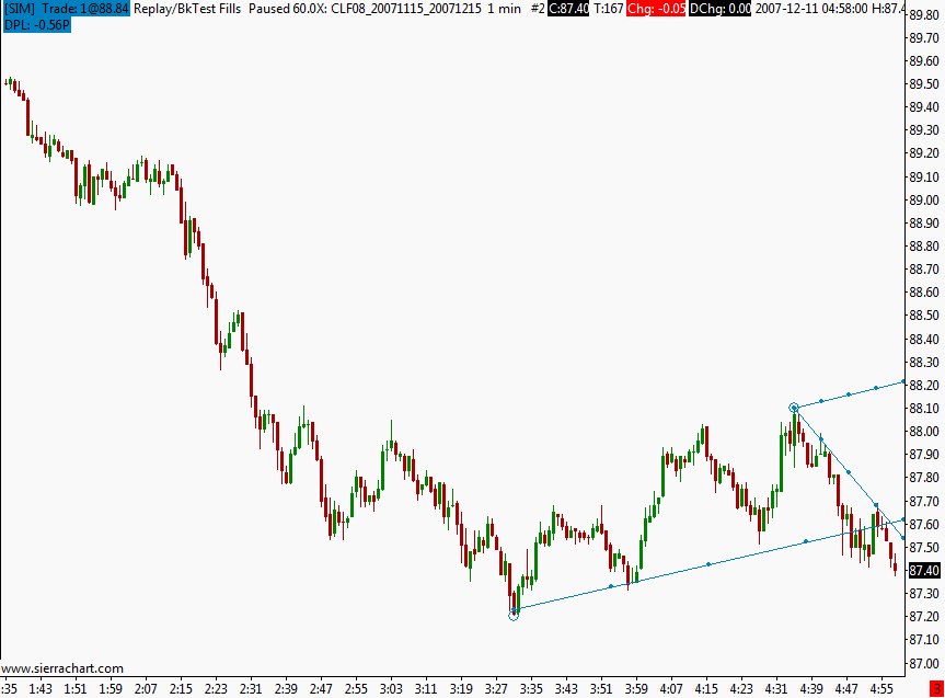

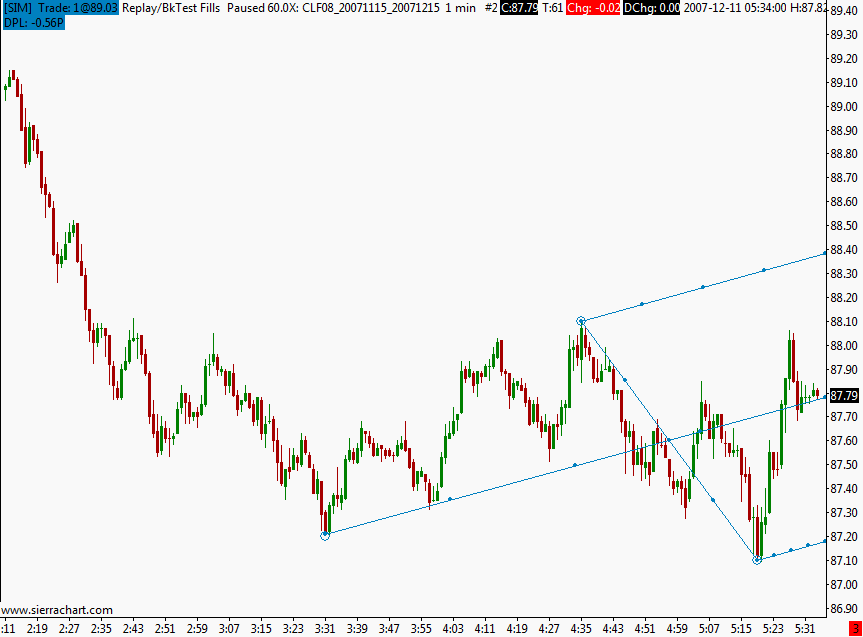

I have found a large error in the drawing of the median line of an Andrews pitchfork, which disappears after scrolling a couple of bars. The parallels are drawn correctly. I think this is a different issue to the earlier report of inaccurate drawing. There are enough bars between the pivots to get a reasonably accurate drawing.
http://www.sierrachart.com/image.php?l=1367899432109.png
http://www.sierrachart.com/image.php?l=1367899503932.png
http://www.sierrachart.com/image.php?l=1367899851187.png

I found that the A bounces around a lot if I scroll when the last bar on the right is near the B-C mid point. Further away from the mid it settles down.
