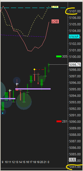

Dear Support:
Is there a programmatic way (via ACSIL) to determine the upper/lower bounds of the price axis?
In other words, if the price axis is showing 5083 (lower bound) to 5107 (upper bound), how can I determine that via ACSIL?
See attached chart, in case the question is not clear.
Thank You!
imageCapture4.png / V - Attached On 2024-04-24 17:20:29 UTC - Size: 14.98 KB - 260 views
[2024-04-24 19:06:29]
emmanuel - Posts: 63
Try the function
sc.GetGraphVisibleHighAndLow()
See ACSIL Interface Members - Functions: sc.GetGraphVisibleHighAndLow()
