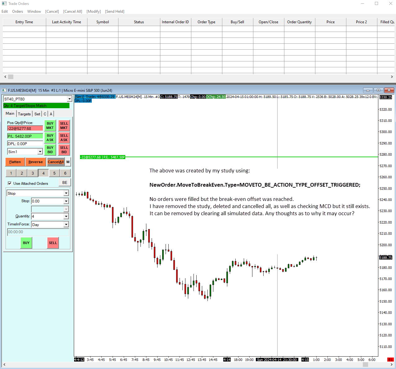

The example does not suggest a test for working status is required however when I place a Buy_Limit order or a Sell_Limit order and it is not filled I still get an unexpected line
when the Breakeven offset is triggered. This is shown in the attached image. It also seems to present the PnL from the Entry?
The line can only be removed buy "Clearing all Sim Orders and Data."
Any help or direction appreciated.
imageSierra ACSIL Move to BreakEven.png / V - Attached On 2024-04-22 12:25:14 UTC - Size: 81.1 KB - 320 views
