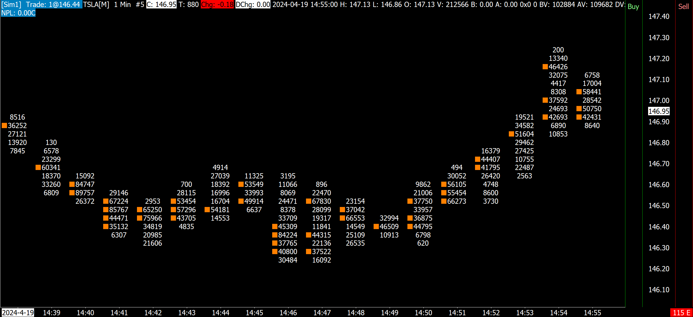

We are not seeing this. When we use the "Volume at Price Threshold Alert V2" the alerts are only located at the aggregated prices.
Attached is a screenshot of what we see when we ran the test for TSLA. The settings for the "Volume at Price Threshold Alert V2" is for total volume greater than 35000 and for the chart has a Volume at Price Multiplier of 4.

Thanks John, this was helpful in getting to the issue I'm seeing. It appears the multiplied levels are only not respected when the setting of "Draw extension lines" is set to "All prices in adjacent alerts".
When using this setting, it draws lines at price levels inside/outside the multiplied levels.
When not using this setting with any other configuration mix, it seems to draw everything as expected with the multiplied levels.
