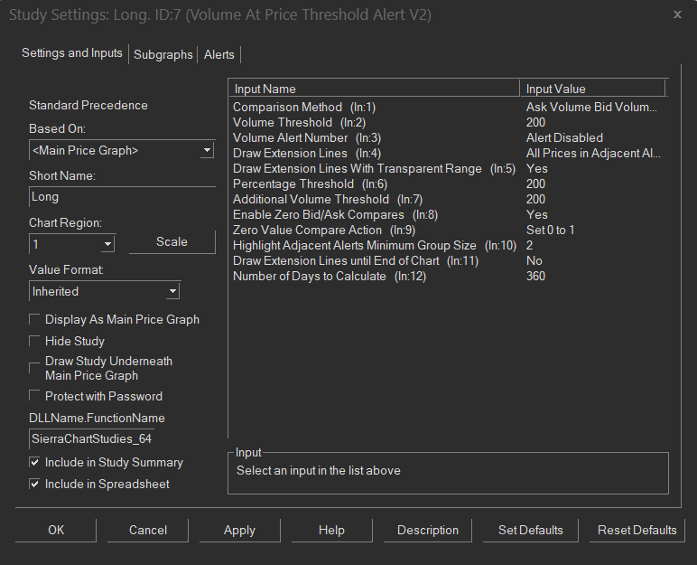

[2024-04-12 19:36:51]
User585993 - Posts: 83
I was able to get the posite delta using a second "Volume at Price Threshold Alert V2"as per your advice with the method Ask Volume Bid Volume Difference. For the negative delta I have issues, do I use the same method or what am I missing?

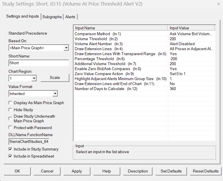

That's what I have
imageABC.png / V - Attached On 2024-04-12 19:49:57 UTC - Size: 51.9 KB - 227 views
[2024-04-12 20:58:25]
The entry for "Percentage Threshold" only applies when the "Comparison Method" is set to "Ask Volume Bid Volume Ratio".
If it is set to "Ask Volume Bid Volume Difference", then you need to enter -200 in the "Volume Threshold".
