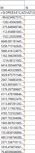

I want to use the slope function in the spreadsheet, with the x values being a MA and the y values being time. So I used the bar duration but in the spreadsheet it doesn't show as seconds interval. attached is that it's giving me. I'm using renko.

[2024-04-12 16:34:08]
That is the time in the native format. Select that column then select "Spreadsheet >> Number Format" and select "Time" for the format.

Thank you that worked, but now I think I have a different issue. Not sure if it's suppose to look like this (attached photo). I used the same approace as the documentation in regards to using the last 10 close prices and last 10 time intervals.

[2024-04-12 17:20:54]
We can not say that it is wrong. That is, you need to keep in mind that since you are looking at Heikin-Ashi bars, the time is not constant. So even though you have a Moving Average that looks good over given time period, the slope of the line over the bar periods is going to be different for every point.
