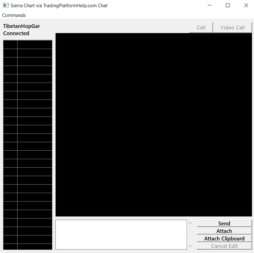

6. The group will be created and listed in the list of chats on the left of the Chat Window. At this point, only you are the member and it is your own private chat. Whatever messages you send, are seen by no one else but yourself.
This did not happen, shown in screenshot. I clicked new group and selected telegram to yes and hit apply all and then ok, and tried not clikcing apply all and then ok, and still nothing appeared in the "list of chats on the left of the Chat Window."

[2024-04-15 20:27:28]
Make sure the Group Name is at least 5 characters long. Anything shorter is not accepted.

[2024-04-16 04:58:57]
JabbALot - Posts: 17
Ah yes lol, that did the trick! Thank you.
