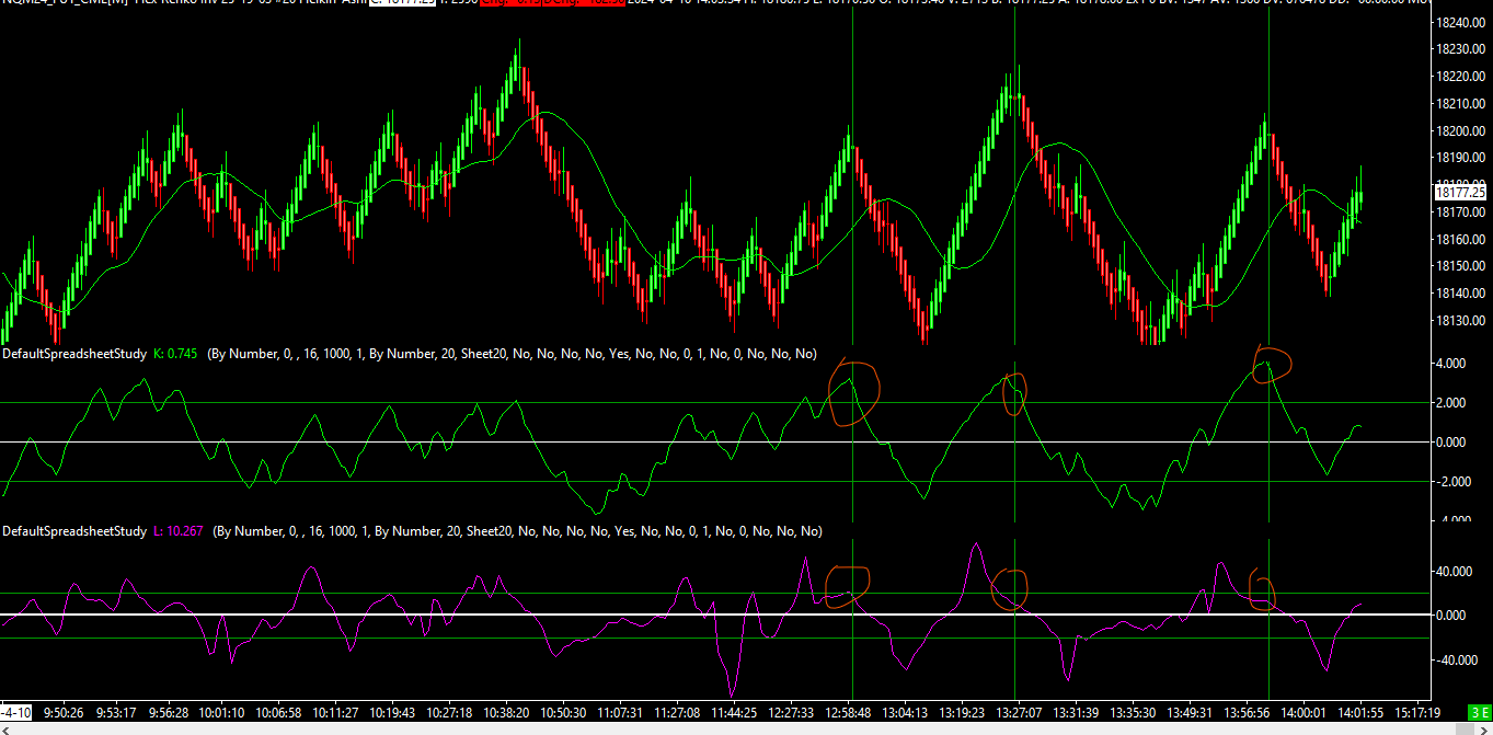

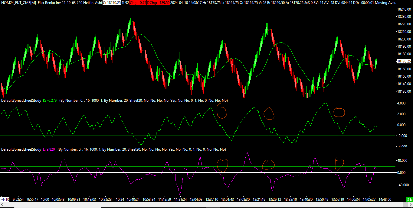

I'm using a formula in the spreadsheet study but after every new bar the study shifts. attached are 2 pics. I have 3 orange circles with vertical lines and after a few bars you can see how the study shifted.

[2024-04-10 18:13:03]
User411320 - Posts: 379
im just using the STANDARIZE function

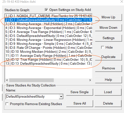

[2024-04-10 20:38:16]
Hello John,
I have multiple copies (circled in orange ), please see attached picture.
I don't need both though, just the bottom purple one. So if I have to delete one that's fine

[2024-04-10 20:47:55]
John - SC Support - Posts: 48587
You can have multiple copies of the Spreadsheet Study, but you can not use the same Spreadsheet Name and Sheet Number. This is probably at the heart of the issue you are having, as there is a conflict with it updating the data.
Please remove one of the Spreadsheet Studies and select "Edit >> Reload and Recalculate" and then see if you continue to have an issue.
