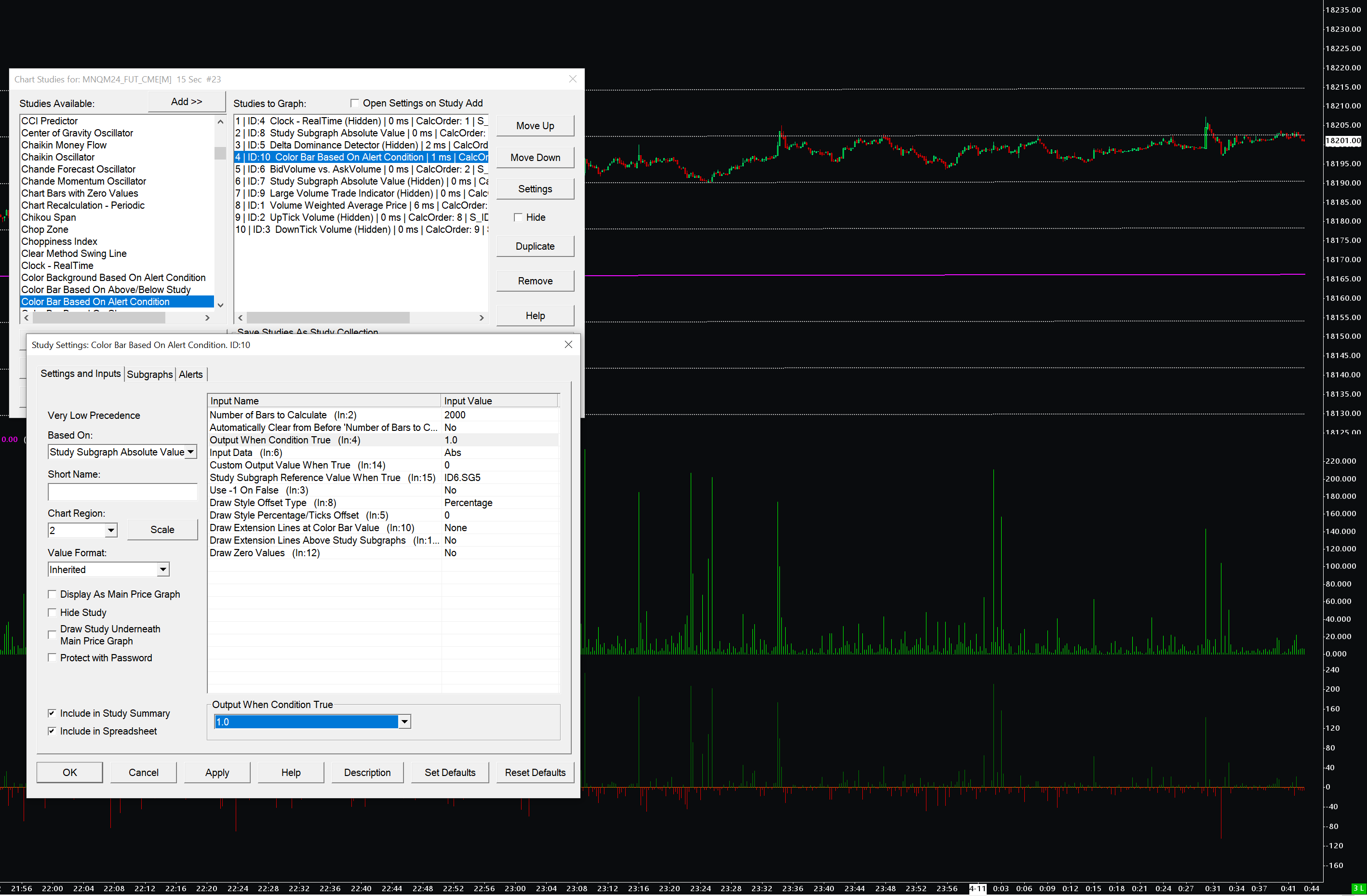

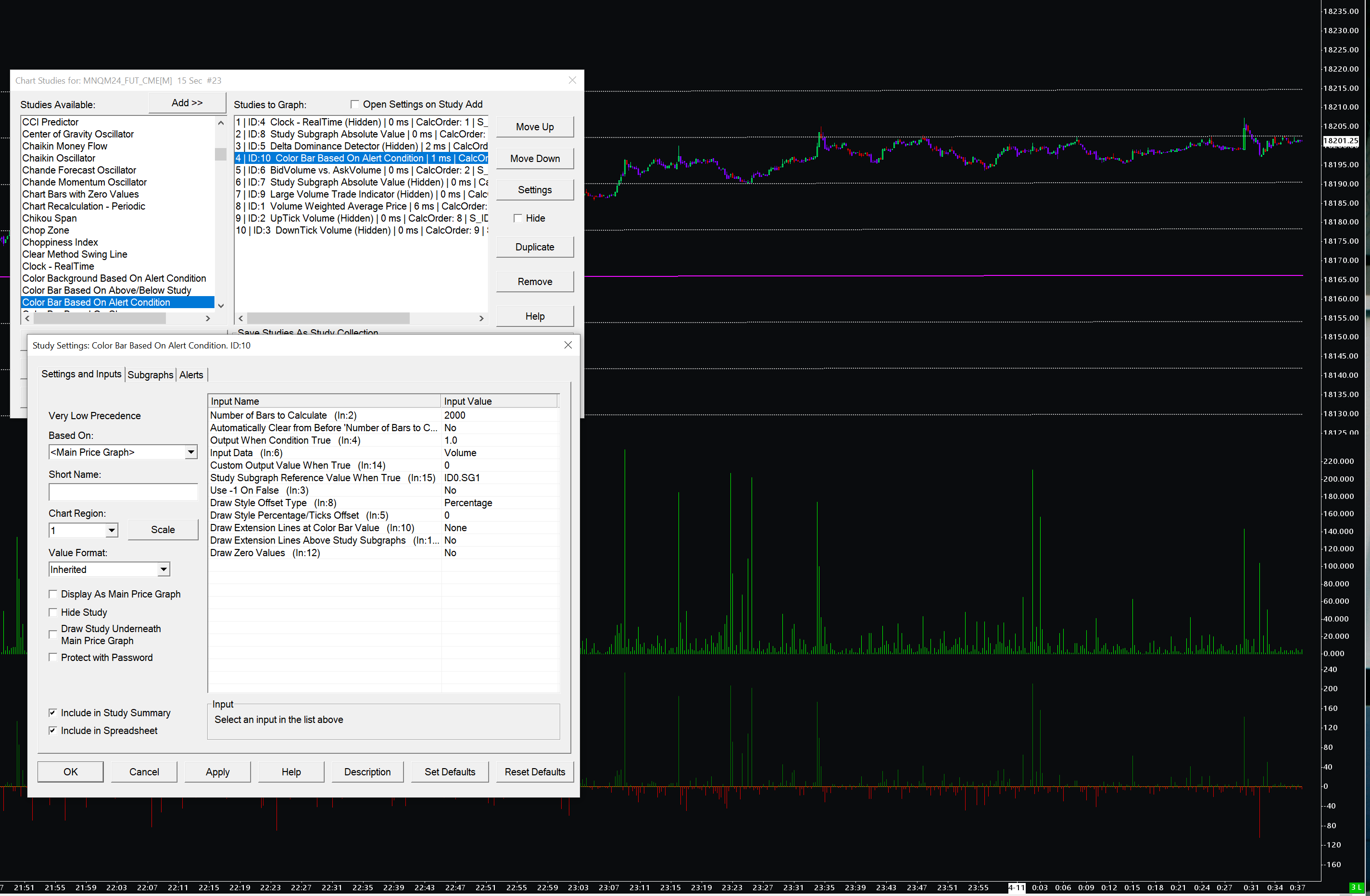

I have managed to get the alert condition working using =id6.sg5<0 which corresponds to the correct study and input. I don't have any issues placing it on the main price graph but can't get it to color bars in charge region 2 where the absolute value study is. I've atttached images of the settings I've tried, one being on main price graph which works, and the another where it will not color on region 2.
Thank you!

[2024-04-11 14:48:35]
The "Based On" needs to be set to the study that you want to color (we think you have this correct, but we do not know for certain). Then the "Output When Condition True" needs to be set to "Use Input Data".
Then make sure that the Subgraph settings match the same as the study you are trying to color (i.e. it should be Bar and whatever width you have set on the other study).
[2024-04-11 15:22:21]
User488241 - Posts: 44
Thank you it was the subgraph setting that was keeping it from working. I had it on Color bar instead of bar. Interesting how colorbar will work for main graph but not for other studies.
