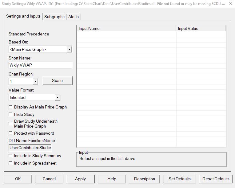

My weekly/Monthly/Quarterly/Yearly VWAP charts have stopped working, reporting the following error:
Study Documentation: Error loading: C:\SierraChart\Data\UserContributedStudies.dll. File not found or may be missing SCDLLName line.
(see screen print attached)
Can you help repair please ?

The file named "UserContributedStudies.dll" is missing from your system. Typically this is because a Virus Scanning software removed it. You will need to put an exception in your virus scanning software for this file to ensure that it does not get removed again.
To get the file back on your system, you need to update your system. You can "update" to the same release you are on now, and any missing files will be put in place, but if you are not on the current release then we recommend updating to the current release to ensure you have the most up-to-date software. Follow these instructions to update:
