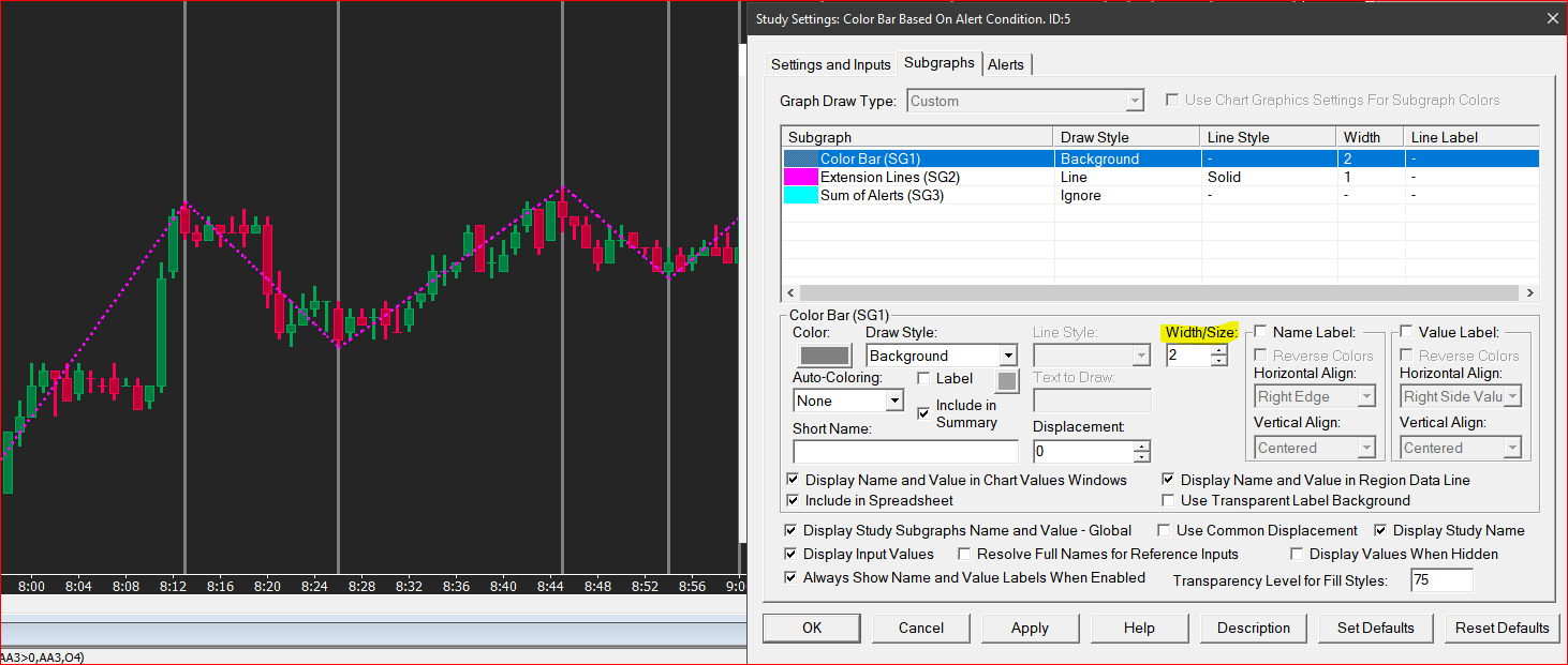

How can I have the alert draw a vertical line
I tried color bar but it is not what I want
Thaks

[2024-04-08 19:22:36]
Sawtooth - Posts: 4361
Use the formula in post #2 on the Alerts tab of the Color Bar Based On Alert Condition study, then use the Background draw style, set to Width 2.
This is the best available.
Unfortunately, there is no Vertical Line draw style.

[2024-04-09 13:50:16]
I can't find any "wide".
See attached.
Note: I am not SC Engineering; I am only a user.
imageZZ Vertical lines.PNG / V - Attached On 2024-04-09 13:50:11 UTC - Size: 62.7 KB - 246 views
