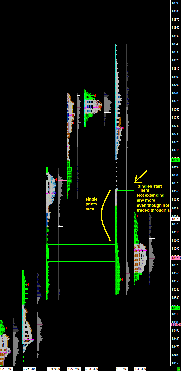

First, thanks for this addition, it is great!
However, I am not sure if it works as intended or maybe there is a setting that I am unable to find.
Before you added the option to display single prints (in TPO profile) as an area, if the extension was set to Until Future Intersection, Single Prints starting line extended on the chart as long as the price action did not intersect that STARTING PRICE of the singles.
Now, no matter what the setting (i.e. as area or not), Single Prints stop extending as soon as new price action goes through at least one single print within the area.
I believe this should not be so because as long as there are some singles left, it should still extend (as line from the start of them or as the remaining area).
I am attaching a screenshot. This is without setting singles to area, just the line for the start of SPs.
Thank you.
Regards,
Hana

We need to get that particular chart for testing. Instructions:
[2024-04-10 07:02:38]
User740709 - Posts: 159
OK, here it is.
However, you do not need to request it from me. You should be able to reproduce it by just adding the TPO chart to any symbol daily chart and set the singles to extend until future intersection.
That´s what is in this attached chartbook.
I am again attaching a screenshot as well.
Regards,
Hana
PS: As the session times might change for you (as it happens when I copy a chart to a different chartbook), just FYI, it should be set to 08:00-17:15 CET (Frankfurt time zone) as that is what the screenshot is showing.
