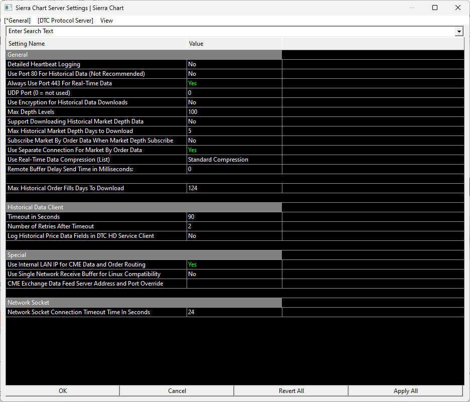

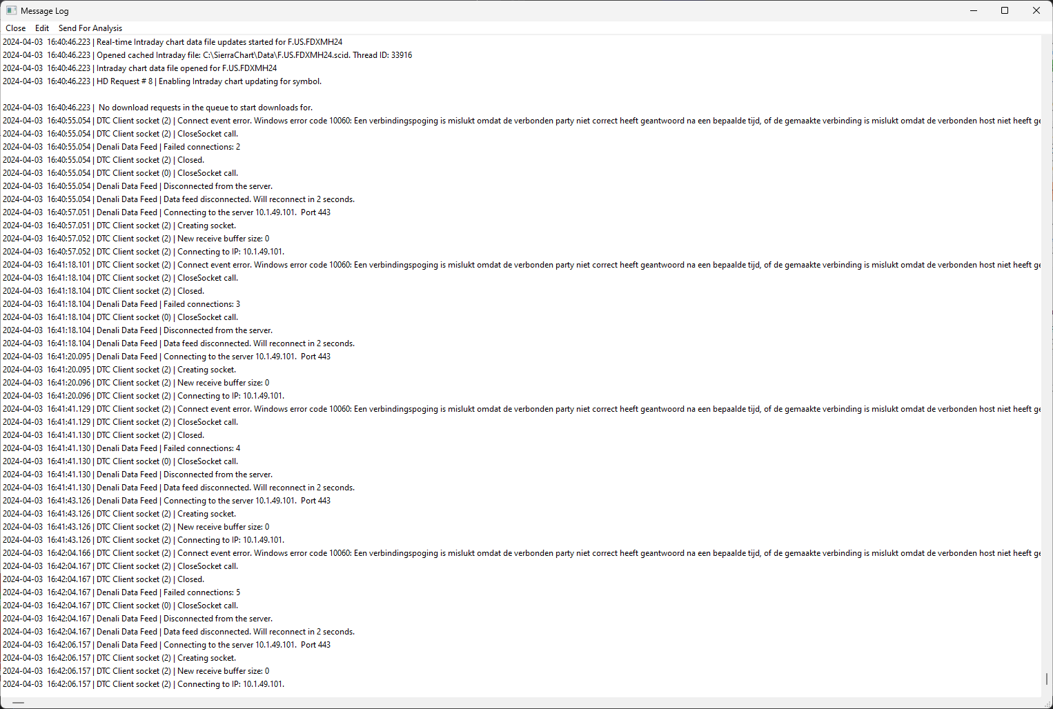

A connection error has found its way into my SC. I have - unfortunately - yet been unable to resolve this.
1) I am running the latest version of SC (2626)
2) I restarted the computer
3) I flushed the DNS
4) Tried YES & NO on: "Always use port 443 for real-time data"
5) Tried YES & NO on: "Enable DTC Protocol server"
6) This help page did not provide a solution (LINK: Data/Trading Service Connection and Symbol Issues: 1.2. Network Communication or Server Problem)
Please see the message log and settings below in the attached images.
Hopefully this can be resolved fast - I usually manage solving tech issues with SC, but this time I am in the dark..
Thanks!
imageMESSAGE LOG.png / V - Attached On 2024-04-03 14:57:13 UTC - Size: 113.17 KB - 245 views
imageSETTING 1.png / V - Attached On 2024-04-03 14:57:20 UTC - Size: 45.78 KB - 257 views
imageSETTINGS 2.png / V - Attached On 2024-04-03 14:57:24 UTC - Size: 42.21 KB - 193 views

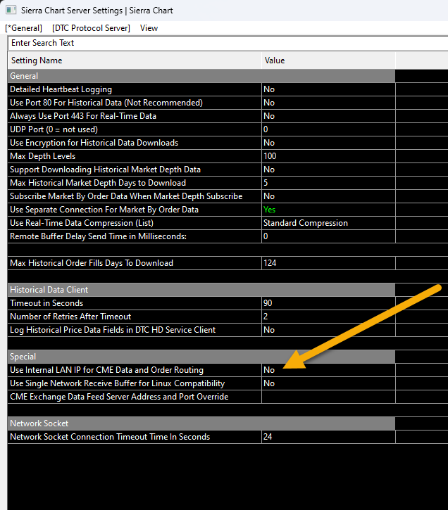

Solution was found in a setting that was turned to YES. See the image attached to this post. Hope it can help someone else in the future!

[2024-04-05 16:13:49]
Yes we apologize for not recognizing that. This has now been added to the documentation here:
