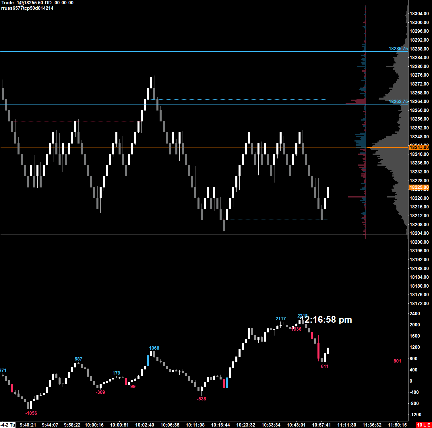

Using the 'color bar on alert' study, I am using the same formula that colors my delta bars (blue/red) to draw extension lines on the main chart. However, these don't appear to be plotting correctly in real-time.
There are 3 extension line examples in the attached image.
1) The first red extension line (price - $18255) plots as expected, but on the next candle's wick, it stopped drawing. It wasn't until the retest ~10:00 that it started to redraw this extension line.
2) This blue extension line (price - $18265) should have stopped plotting after the crossover, however it is still plotting.
3) Similar to example 1, this line (price - $18210) stopped drawing after the wick crossed it on the next candle, it wasn't until the retest at 10:57 that it started to draw it again.
Any ideas what might be causing the inconsistency in plots? Have I misconfigured a setting or is this a bug?
https://www.sierrachart.com/image.php?Image=1712074618401.png
1,3)
- Each of the 5 red lines start and end as expected, if 'Extend to Future Bar Close Crossing' is selected.
2)
- The blue line at 18265 should have stopped as you say, but check the Close/Open at ~10:05 to see if there is a gap for the line to slip through,
assuming 'Extend to Future Bar Close Crossing' is selected.
- The blue line at 18210 should have stopped at ~10:57 unless that close is just above the line.
These issues might be correctible by increasing the granularity of the Value Format in the Color Bar studies.

UTkRussell - Posts: 31
