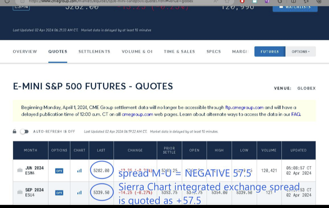

The sierra chart integrated spread for ESM24-ESU24.FUT_SPREAD.CME
Front minus back is negative as per the image I have shared as attached.
The spread is negative as per CME pricing. Front M contract minus back U contract.
Why does sierra chart have the exchange listed spread as positive at 57.50?
SC is not pricing this spread correctly.
This seems to be the case with all CME Equity index intra spreads.
Hopefully there is a simple resolution to this.
imageScreenshot_20240402-165808.png / V - Attached On 2024-04-02 15:58:29 UTC - Size: 448.77 KB - 234 views

The spread is negative if you calculate it between M and U. yet sierra charts shows a positive spread on the ladder and any charts of the spread.
So something is clearly incorrect.

The ladder shows the wrong price. It's that simple. I'm not pointing to what the specific issue might be, data or software, but the ladder shows an incorrect price and it is wrong. It clear to see and needs resolution.
I will have to resolve this by writing a custom spread.
The lack of any recognition that the ladder is showing a positive when the spread is negative is extremely disappointing.
I'm simply asking for you to investigate this as a paying customer and long time user.

The CME would not agree with this:
And we have validated in the CME test exchange environment, that positive pricing for this spread is valid. This is how they do it.
