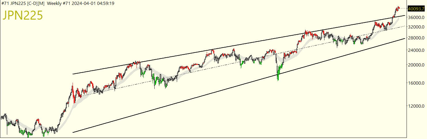

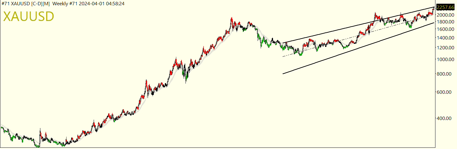

I recently updated to version 2625 and noticed a discrepancy in the plotting of Linear Regression Channels when using this tool. Previously, they were symmetrically positioned on both sides, but now, some appear wider on one side for unknown reasons.
I have attached two charts illustrating this observation for your reference.
Best regards,
https://www.sierrachart.com/image.php?Image=1711961971982.png
https://www.sierrachart.com/image.php?Image=1711961905381.png
Date Time Of Last Edit: 2024-04-01 09:01:58
[2024-04-01 15:16:37]
We assume you are referring to the fact that the Linear Regression is wider on the left and narrower on the right.
This would occur if the scale for these charts is logarithmic, which it appears they are from what we see of the prices.
