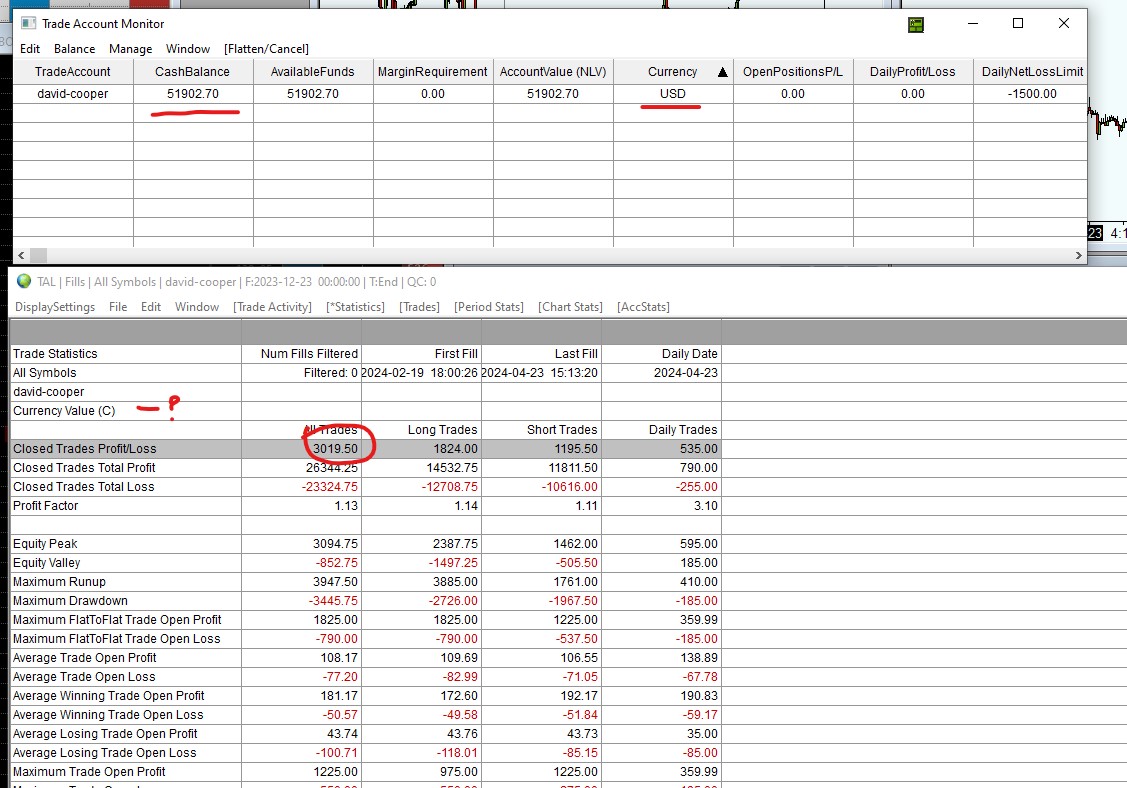

rocdjc - Posts: 12
I have a custom screenshot showing my trade log at 3019.50 (this is USD and correct).
Versus the Trade account Monitor showing only 1902.70. This is incorrect.

[2024-04-24 11:47:59]
The currency of the Trade Account Monitor does not change. It is fixed at USD unless the account is created in another currency.
[2024-04-24 12:00:41]
rocdjc - Posts: 12
yes and it is reporting the incorrect USD values per my screenshot.

[2024-04-24 13:26:48]
We need to see why the currency conversion is not taking place. We need a few days.

[2024-04-24 20:16:36]
We should have this resolved this evening.
This is not going to change existing account balance adjustments where a currency conversion should have taken place but did not, for trading in futures contracts in other currencies, different from the currency of the account balance.

[2024-04-26 06:55:04]
rocdjc - Posts: 12
I did just want to confirm that this case//support request can be closed :)
Everything is working perfectly now on Trading Evaluation mode! Currencies are being converted to the account summary accurately.
Thank you very much!
