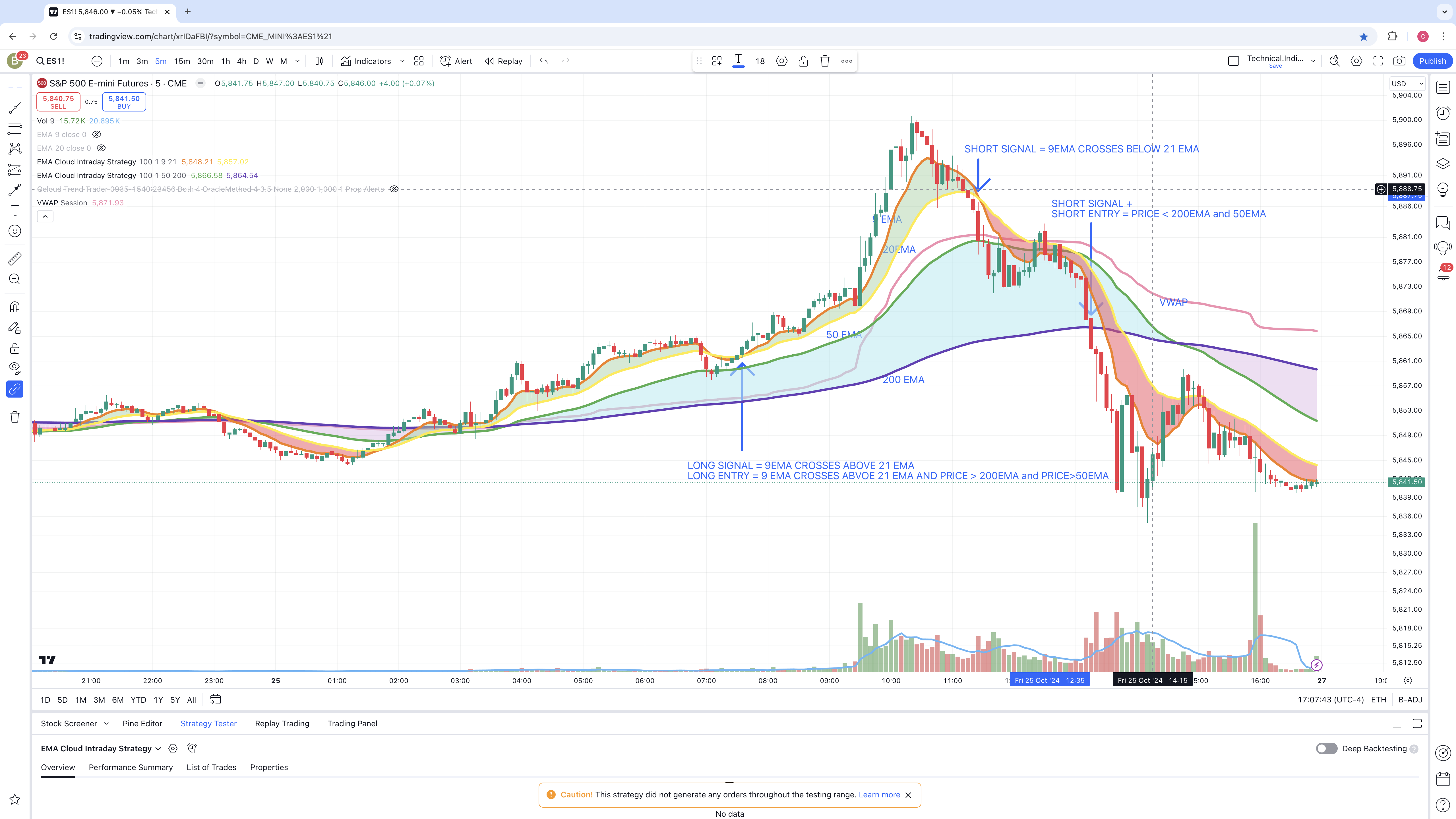

[2024-10-27 15:06:43]
User643426 - Posts: 144
Okay I understand. I've attached a screenshot of the study below
imageScreenshot 2024-10-26 at 5.07.44 PM.png / V - Attached On 2024-10-27 15:05:24 UTC - Size: 1.33 MB - 413 views
