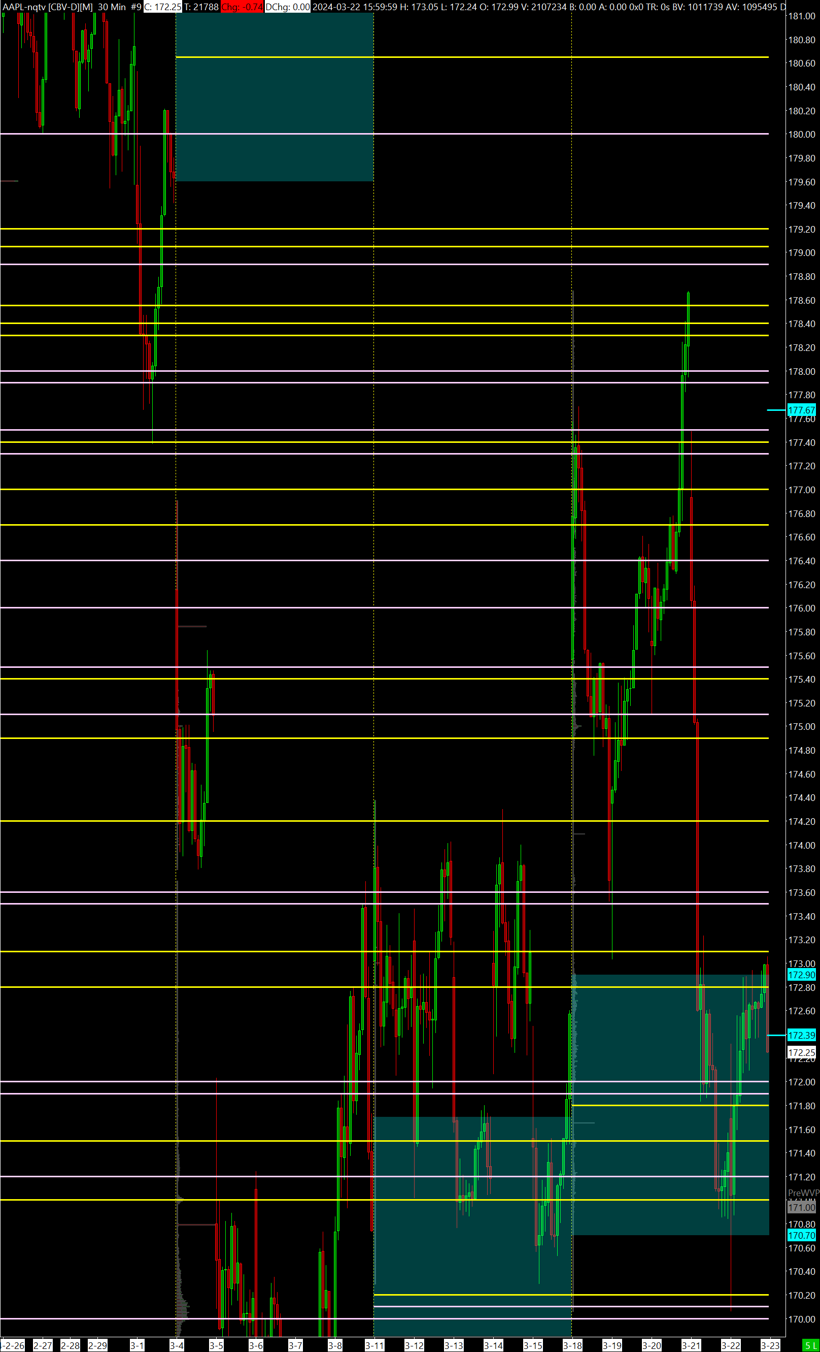

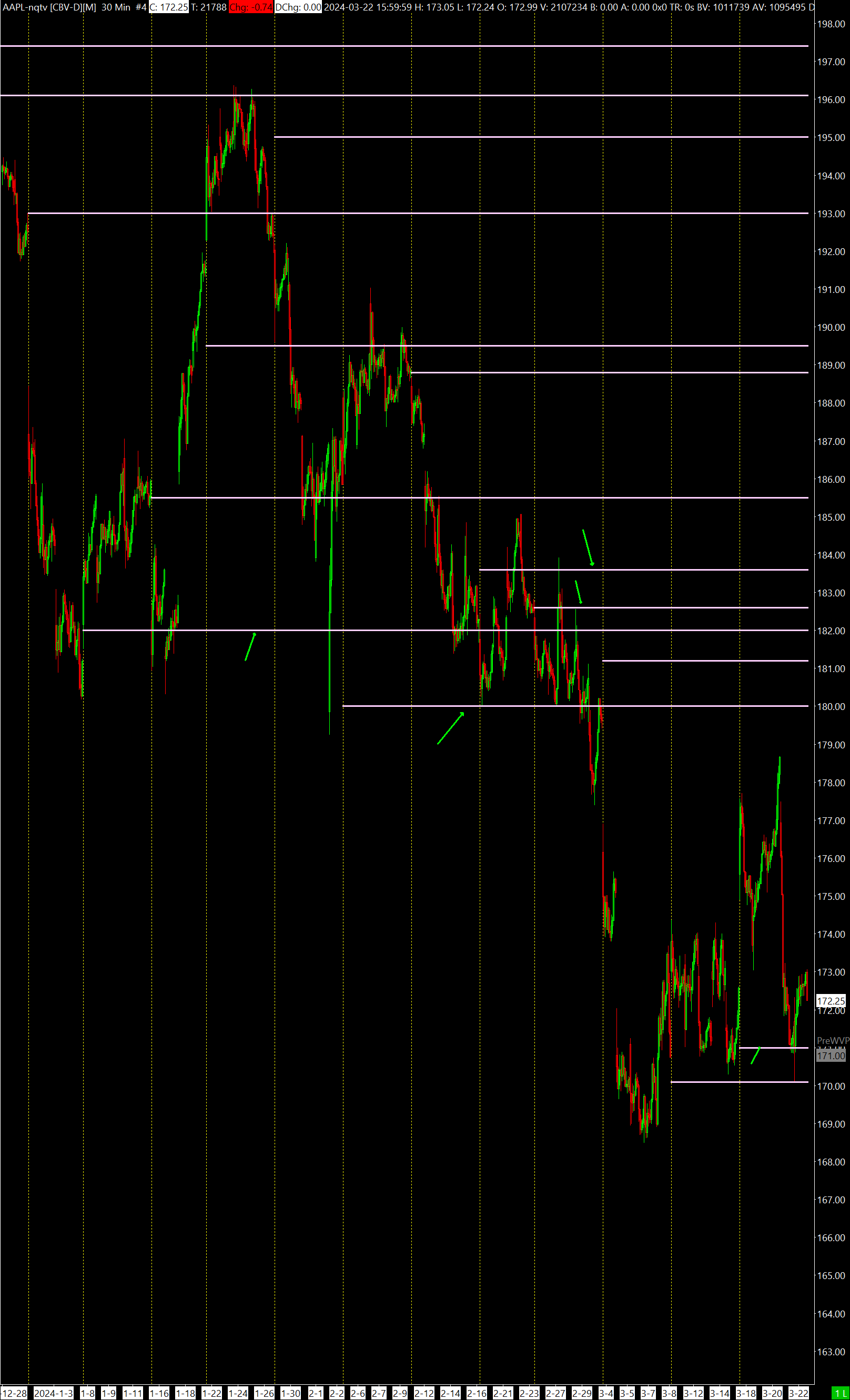

To clarify, what the study is extending are volume POC's from a weekly "Volume value area Lines" study.
In the first attached picture you will see many of these extended lines , deriving from weekly value areas going back to the beginning of the year.
I have used some arrows to highlight a few of the lines that should have ceased extending (when price intersected them).
https://www.sierrachart.com/image.php?Image=1711297104275.png
Another screenshot with just the original study:
https://www.sierrachart.com/image.php?Image=1711297169627.png
Finally a screenshot with "separation" (which I understand to mean increased bar spacing):
https://www.sierrachart.com/image.php?Image=1711297497480.png
